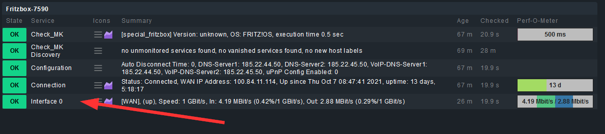

Yeah, I finally got it running. For the sake of completeness, here is my procedure:
sudo cp /omd/sites/testrechner/lib/check_mk/base/plugins/agent_based/fritz.py ~/
sudo chown testrechner:testrechner fritz.py
sudo chmod +x fritz.py
sudo nano fritz.py
→ EXACT changes from your diff
sudo mv fritz.py /omd/sites/testrechner/local/lib/check_mk/base/plugins/agent_based/
Here we go:
Thanks a lot for your help! And sorry again for the inconvenience.

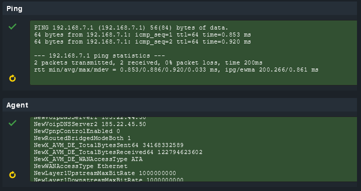

Hm, for some reason I encounter another problem. While the the “Interface 0” counters are still correct and refreshed every minute, I am seeing this errors since about 3 hours:
Any ideas again?
As the state is shown as “unknown” it should also show something else inside the agent output.
But it looks strange.
