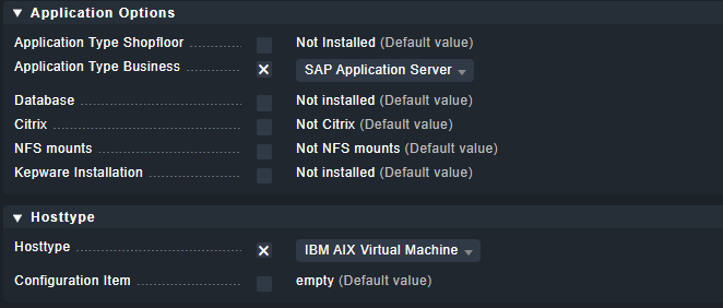

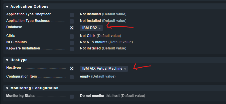

hello, what exactly do you mean by “templates” or “rule templates”? is it a feature within checkmk? maybe give me an example!
A template is a set of rules defining an environment.
E.g. we have a Template for Linux Servers where we define certain things:
  • Checks we dont want (disabled checks)
  • Levels for CPU, Load, Filesystem, uptime etc.
  • Monitoring of defuntc processes
  • Monitoring of general processes like virus protection, inventory for CMDB etc.
The condition in the rules is using a tag like linux for above.
For Windows we maintain a tag for each Version and an AUX tag WINDOWS.
Templates exist for various OSs, DataBases, SAP Application Servers, AD Domain Controllers etc.
Or
I hope that clarifies
