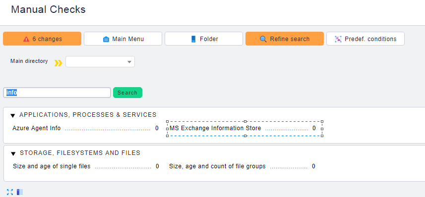

Thanks for your fast answer. I will try to use an example.
If you perform an autodiscovery of a SNMP host, the service SNMP INFO is discovered and you can include it to monitor the SNMP info of this host.
But if you look in the Manual Checks sidebar option and search this snmp info check, you can not find it (at least i can not), so i don´t know how to include this service as a service to be monitored without using autodiscovery
Hope it helps to clarify
PD; I have seen this for SNMP INFO check, but i don´t know if there are more checks that only appears using autodiscovery and can not be chosen as manual checks
