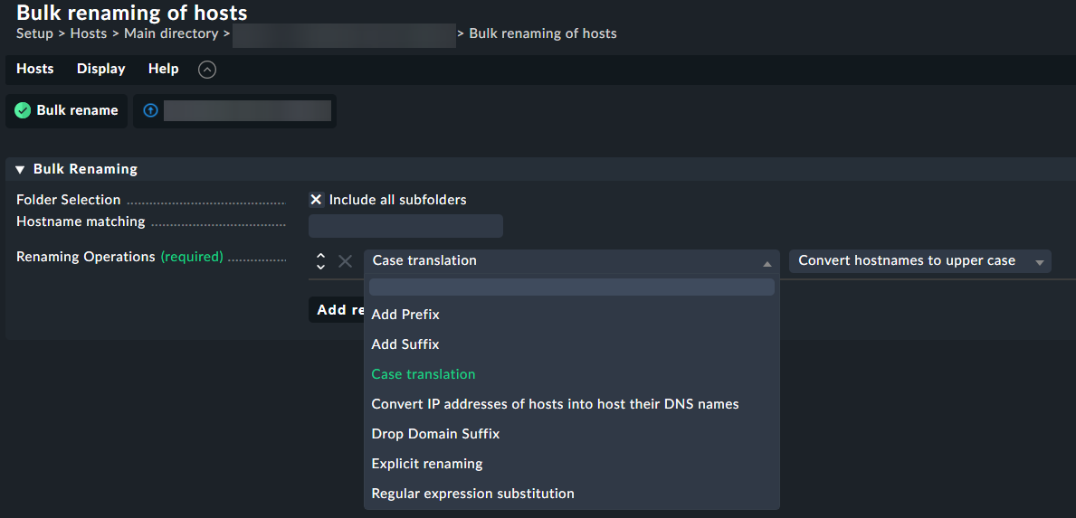

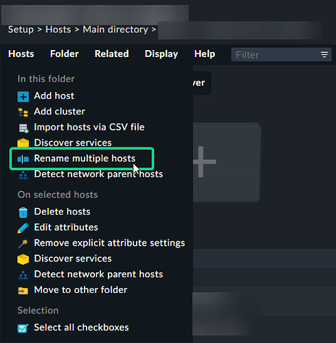

Hi @bo_jinglez,
why is the GUI option not good enough? You can rename multiple hosts with the GUI. This is called bulk renaming in Checkmk.
You can find this function if you navigate here:
Maybe you can provide a bit more information about how you want to rename your hosts.
