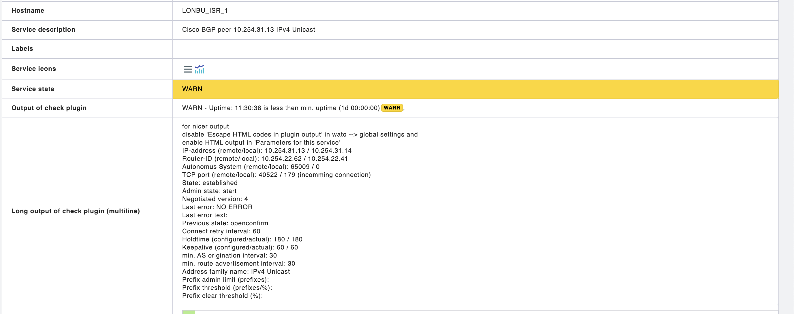

Now with the warning below this is particularly interesting as it states the device has been up less than it’s minimum up time which is 1 day however this plugin has had that state for over a week.

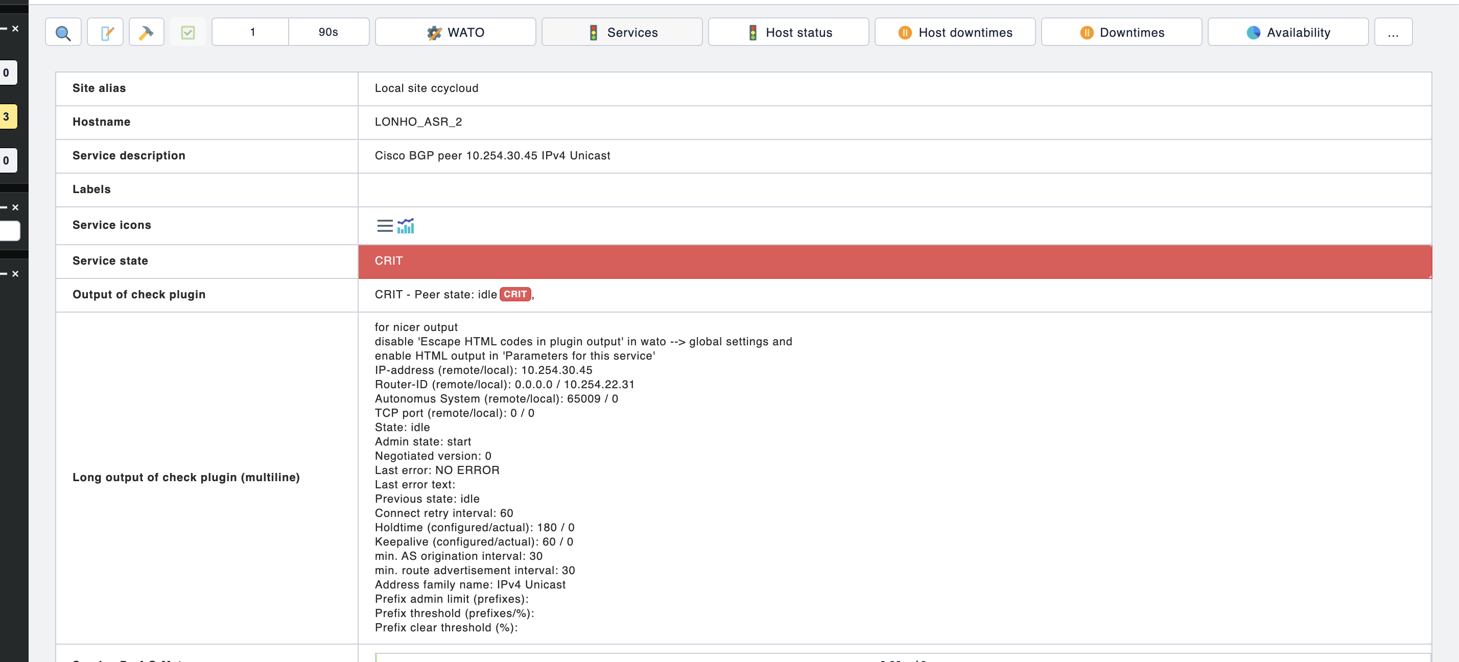

Certain checks never leave pending
The critical check seems to always be the same as shown in the screenshot below does anyone have any ideas how to best configure the plugin and get rid of the annoying errors.

You can define the minimum uptime of your BGP peer inside WATO.
The issue is that even though it has been more than a day we are still seeing the warnings saying less than a day and I am not sure how to resolve CRIT - Peer state: idle CRIT , or why it is occurring.
Can you show one of the uptime graphs for a BGP peer?
But if you don’t want to get an error message for the uptime you can also define that a uptime of 1 second is ok with the available WATO rules.
If you don’t want to “idle” state to result in crit you need to modify the cisco_bgp_peer file.
Beginning with line 462 you find the code transforming idle state to crit.
        if peerstate == 1:  # idle
        yield 2, 'Peer state: %s' % cisco_bgp_peerstate(peerstate)
