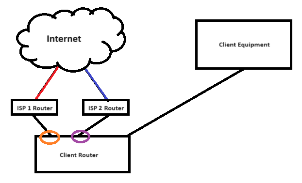

So 4 services are being monitored:
A. [red] Host ISP WAN router 1 - ICMP service only (for uptime, latency and losses/RTT)
B. [blue] Host ISP WAN router 2 - ICMP service only (for uptime, latency and losses/RTT)
C. [orange] Client Router Host with a SNMP service that monitors interface bandwidth to WAN 1
D. [purple] Client Router Host with a SNMP service that monitors interface bandwidth to WAN 2
Availibility report looks at services A and B above and reports availaibility on those those services.
I would like to exclude events/avialiblity calculation during periods where service C (linked to A) and D (linked to B) is in warning or critical state.
This would mean when pulling a availability report for A and B, it neglects any input/affect caused by bandwidth constraints from C or D.
Hope this makes sense and will post a primitive diagram to aid in understanding.

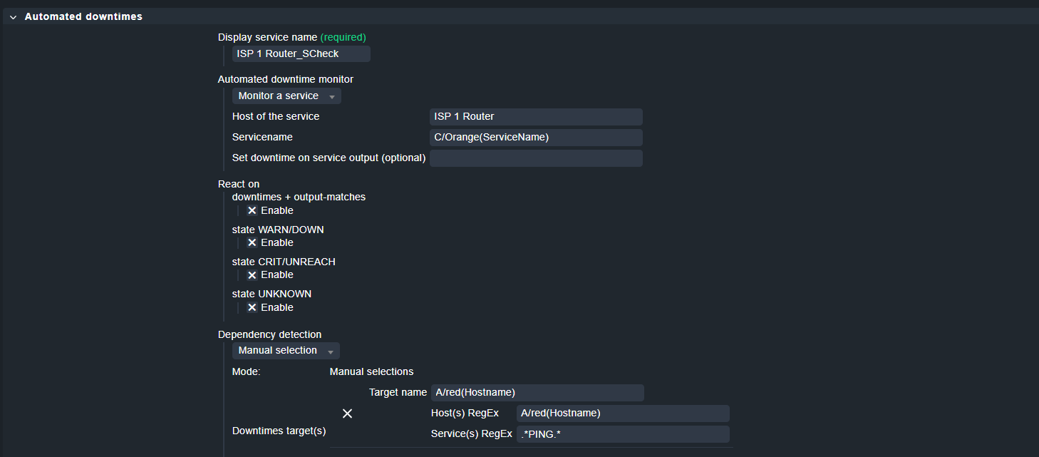

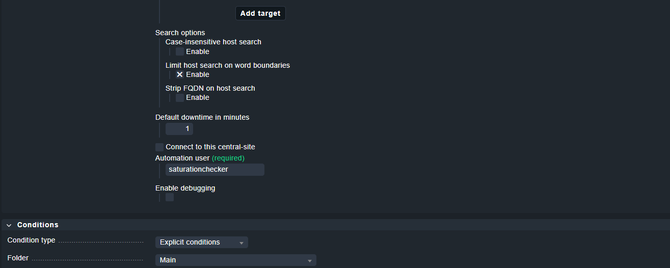

Due to complexities, the regex and fully automated options wont be an option, and I will have to create such a rule for each and every “pair” on each and every device/host/service this is required - or am i missing something? :slight_smile:

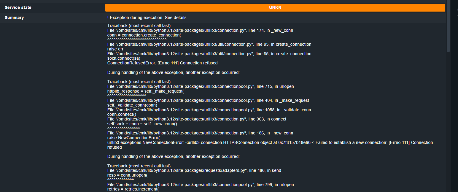

Herewith my manual settings, but this gives me an error :frowning: " ! Exception during execution. See details" (Screenshots below)
[under conditions i selected the explicit host applicable (ISP 1 Router)]

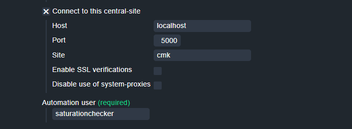

Hi John,
the plugin assumes a checkmk instance running behind an apache that serves https.
Do you use your checkmk on docker or only with http?
To verify if that is it, you could use the option “connect to this central site” and insert localhost:5000 ? does that work?
gerd
Thank you so much! this indeed solved it - we are on docker with no ssl. - error now gone and all green.
