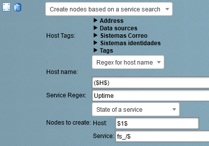

I created a BI rule and used “Create nodes based on a service search” to display the state of a Service2 of the hosts only containing the Service1.
In the Snapshot below you can see the search for Uptime service in the $H$ hosts and how it is used to display the fs_/ service:
imagen
It works fine.
But when I replace the fs_/$ with a parameter $SERVICE2$ of this rule, it displays nothing.
Why?

I am not quite sure what you are trying to do and I am not an expert when it comes to BI but if you are trying to map all fs_/* services this is how i did it.
which after aggregation gave me
br
