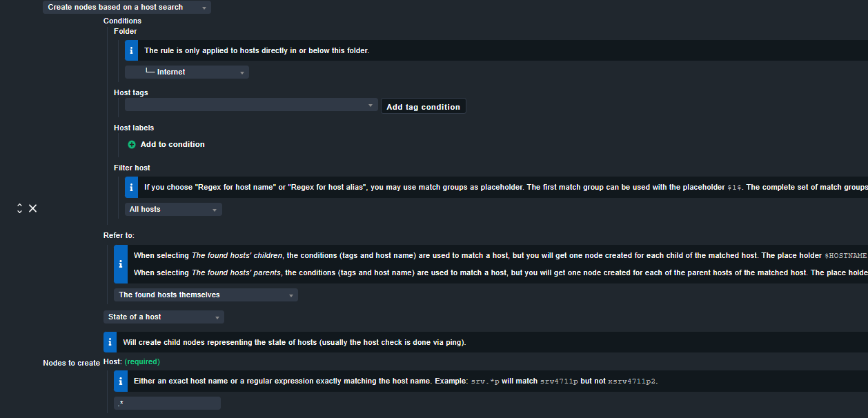

BI rule filter by folder
When creating a BI rule, selecting “Create nodes based on a host search” and specifying a folder, the folder specified is ignored and filtering is done on the host field. How do I specify a rule that should match all hosts in/under a folder?

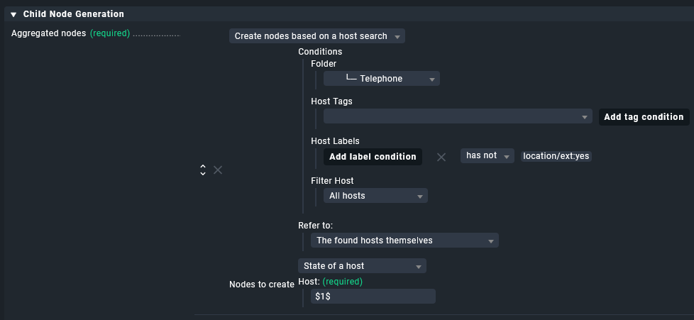

This is my child node generation, where specified folder is not ignored:
Host label condition can be ignored.

Thanks for your reply. This is my configuration:
I have probably made a beginner mistake - I am familiar with Checkmk but I have not used BI much.

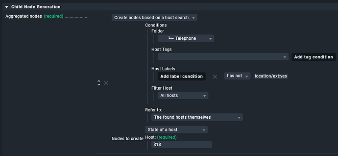

The only thing I see different is Host (required) is not $1$ which is vaguely suggested in the inline help at Filter host.
Hi Yggy,
Spot on - the $1$ did the trick. Not sure I would ever have fixed that without your help.
