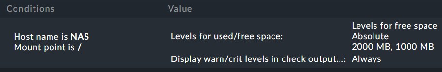

I don’t use such a rule, but i can confirm that there is a bug inside the actual df check.
What i tested.
Generic rule - magic factor 0.6 and lower level if magic factor is used 80/90%
One rule with with absolute levels for one single mountpoint.
→ rule
result in check
warn/crit values are plainly wrong
as @carnold wrote these levels are the lower levels from the magic factor.
