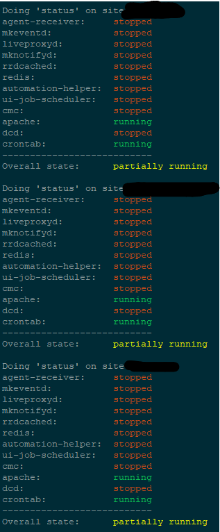

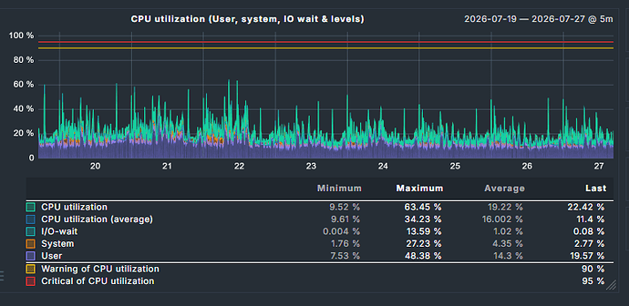

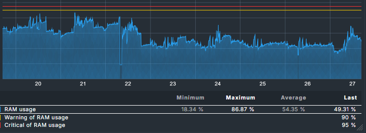

All sites stopped and only crontab + Apache running looks like an OOM kill somewhere in a site process and then systemd stopped all other processes.
This is the picture i had on some smaller systems if i got an OOM kill from a site process.
That’s correct with 2.5 Apache needs way more memory. One Apache that dies will cause all the other site processes to stop.
As all sites are started with systemd and one unit, systemd sees this one process dying and stops all other processes that are started with this unit (omd.service) in a normal way, that’s why the log looks like a normal shutdown.
Only log entry you will see is the system log on the machine no where else i think.

Is it possible that these sites where started with “omd start sitename” or “omd start” inside an SSH session and not with the systemd service? I have a similar problem if i start a OMD site inside a Proxmox LXC container, if i use the Proxmox shell inside the web GUI.
The moment i ended the shell session the site stops, but only if i started the site there manually.
I’m not sure if this file in /etc/init.d is doing right. How and when should Checkmk write the systemd service files? During “dpkg -i”? Or can it be fixed afterwards?
Inside a up to date CMK installation you only need the “omd.service” nothing else.
The init.d service is a “little bit old” and from an old CMK version.
If your site is now started with the omd.service such an “auto stop” should not happen, only if you get the oom problem.
