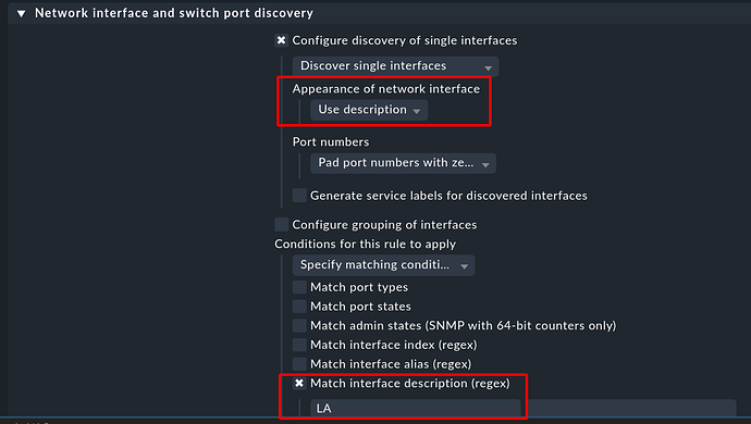

We have the following discovery rule (goal is to use the switch port description for the services):
This rule is working fine and all ports are created with the description (e.g. “Interface GigabitEthernet0/0”, “Interface GigabitEthernet0/1”, …).
But, as soon as we add an additional condition (e.g. “Match interface description”), all the ports are then created by the index only (service/item name then is “Interface 01”, “Interface 02”, …)!

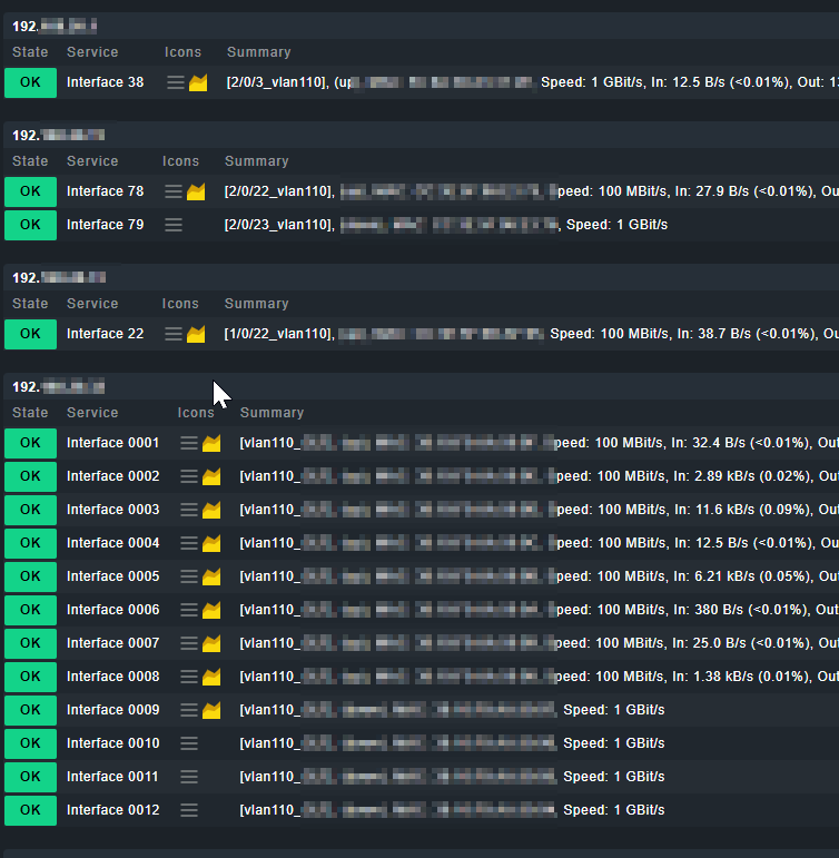

I followed this DOKU Network Monitoring with Checkmk: 3 rules to rule them all | Checkmk and got the result that i can search in “Summary” of Service for (example VLAN110). Is that what you are looking for?
Best regards
my rule:
… and the result:
Karl

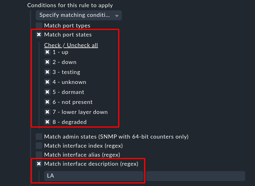

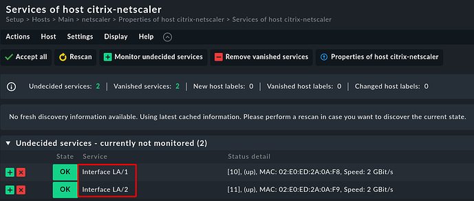

Thanks for your response! Just a question: what happens if you add a second condition? With only 1 condition, it’s also working fine here but as soon as we add a 2nd, it fails.

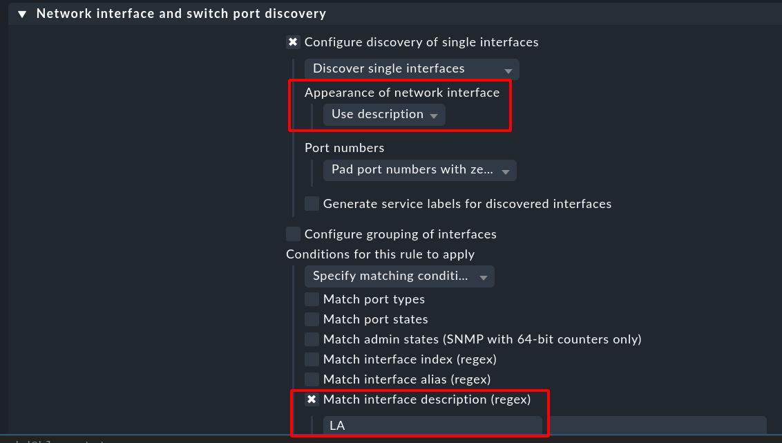

I modified the rule:
The same result as before.
Karl
