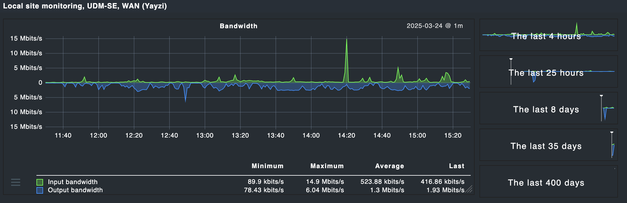

Router (UDM SE) using SNMP V2. Graph was showing in CheckMK RAW 2.3
  • OS version
Ubuntu 24.04.2 LTS Server
Some data has come in but still doesn’t seem right.

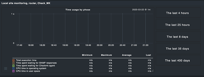

I think, i know whats the problem. If you open the graph page a “FLUSH” command should be issued to the rrdcached daemon. Only after such a flush, you will see the data sent to the caching in the last minutes. With the default config rrdcached writes the data to disk after one hour or so. That is the reason why you see now older data.
You can check this behavior with the following command.
echo "FLUSHALL" | unixcat ~/tmp/run/rrdcached.sock
If you now reload the page, the complete graph should be visible.

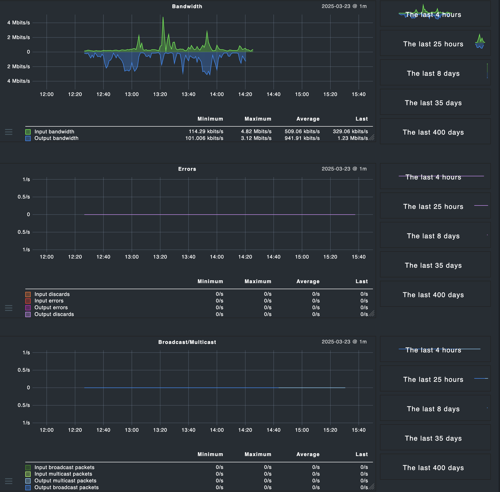

That command worked :slight_smile:

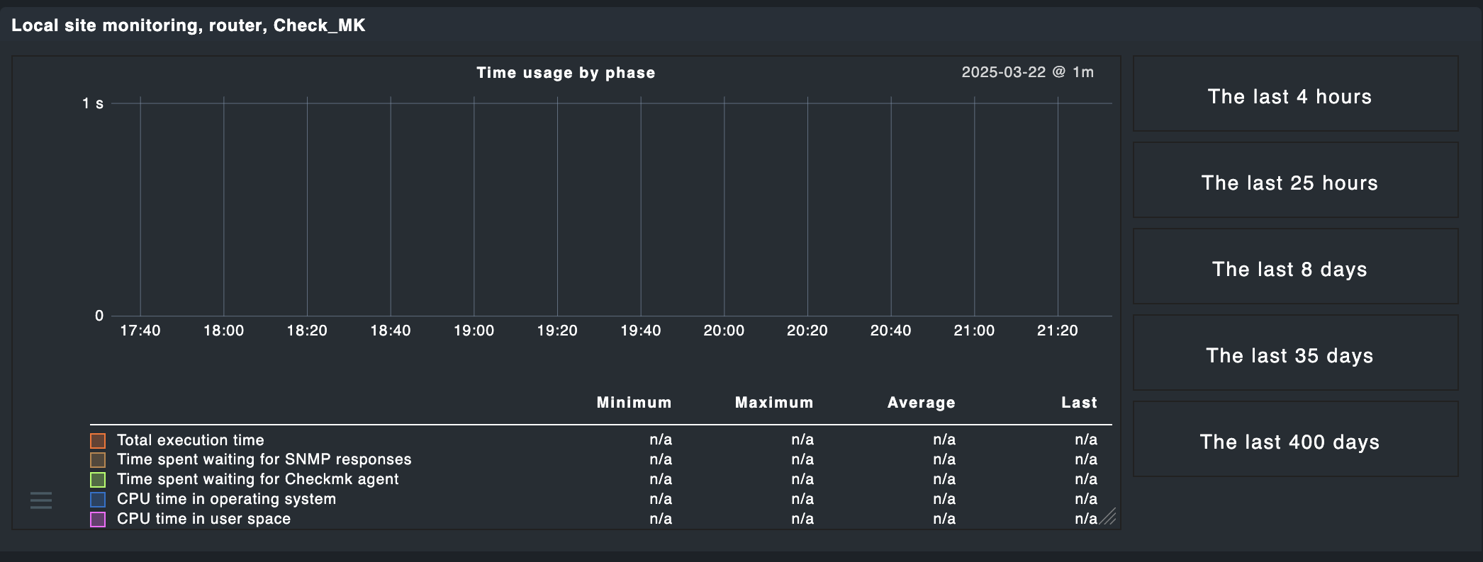

I can provide a little bit more insight as written before. With 2.4 the flush command for the single service looks to be missing.
With 2.3 this command is executed every time you open a page with graphs.
This looks to be missing with 2.4 and RAW edition. In enterprise edition i don’t see this problem.
In 2.3 the data is fetched with one “livestatus_lql” query from the “_fetch_rrd_data” function. Here it looks like that something inside livestatus was changed as it not automatically fetches the newest RRD data. Or better said the columns inside the livestatus table has only old data.

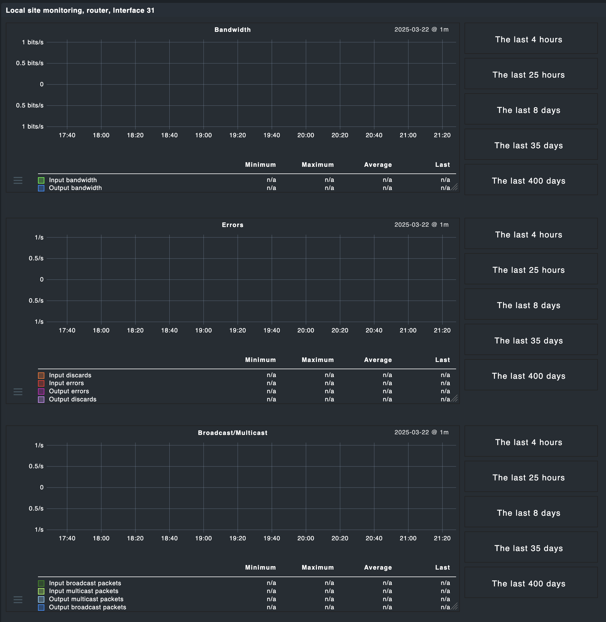

I’m not sure what further info i can provide :frowning:
Its a basic setup RAW installed then SNMP Device (UDM SE) and thats about it.
If I leave it the graph sometimes generates only one metric which is even more bizarre!
Running the command then brings it all

Think this issue might be resolved now! Graphs load when I open the page!

Issue resolved in latest beta :slight_smile:
