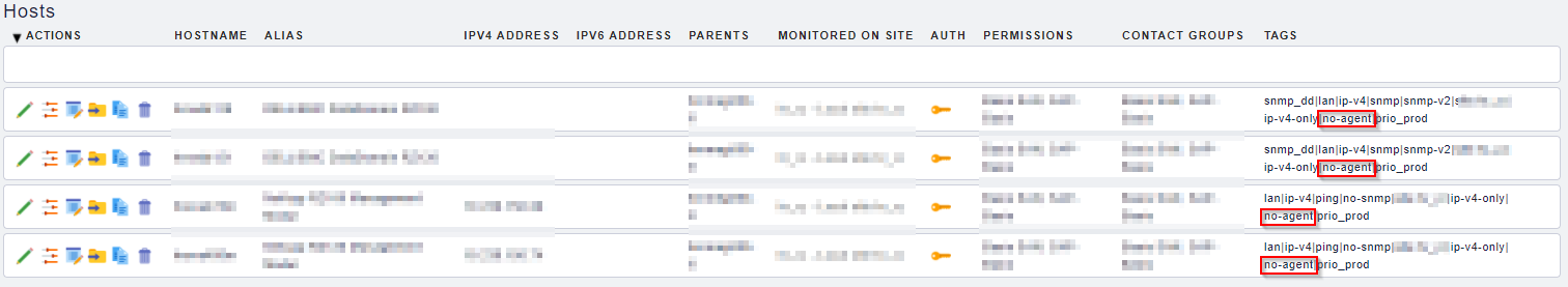

This is not the case, after confirming the dialog on deleting the custom tag group all host are changed back to default value Contact either Check_MK Agent or use datasource program. This affects als hosts which are formerly set to no-agent. It’s not suitable to change back around 3500 hosts manually to there original value.
Hosts before deletion:
Hots after deletion:
(no-agent missing, cmk-agent added)

First remove all modifications like the first picture from @tosch it shows.
Second step is the same as the picture “Hosts before deletion” shows, inspect the tags on the normal hosts.
SNMP hosts should have the tags - snmp:snmp - snmp_ds:snmp-v2 or v1 and agent:no-agent
Normal agent hosts should have - agent:cmk-agent, tcp:tcp, snmp_ds:no-snmp

Look at the first picture @mike1098 , the tag group is clearly there :slight_smile:
