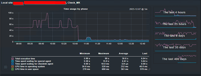

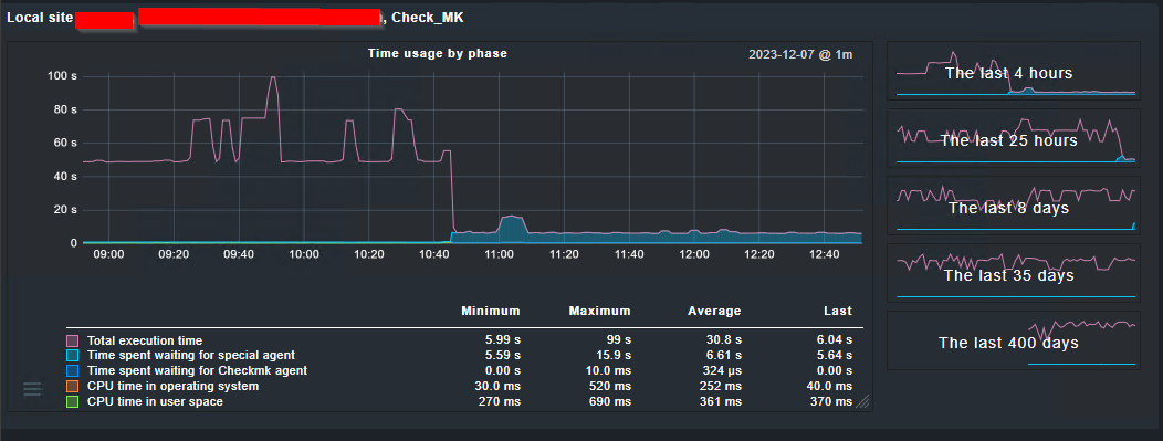

Hello, today i installed either the HPE specific Redfish plugin and the generic plugin to supersede the oh-so-often crappy SNMP disadvantages and to compare both plugins. Here is what happened:
You cleary can see the switch from SNMP to the HPE specific plugin, so thats very very good (>80s va <7s)!
The upper dent at 11 is the short switch do the universal redfish plugin, which took about 16-18s.

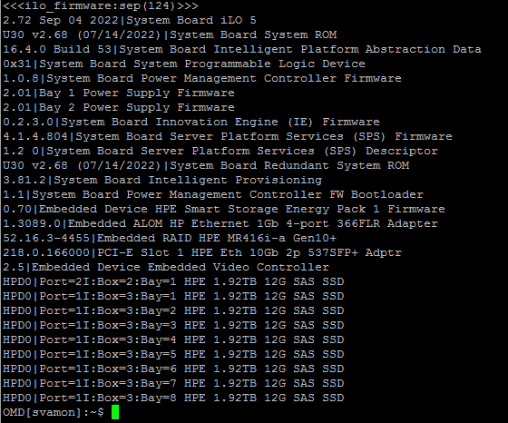

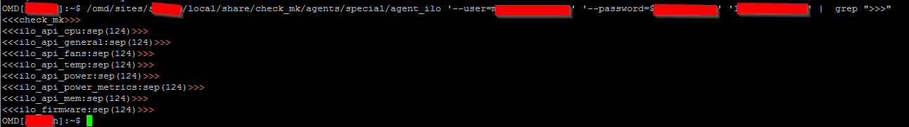

Addendum: albeit being found rawdata in the HPE plugin, disks are not added to the monitoring
grafik
And neither does the universal plugin, although the rest of the services that are added read basically identical at first & second sight.

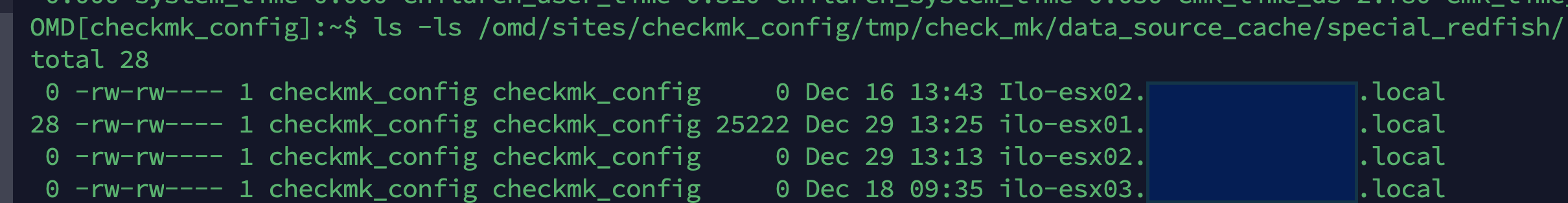

I also noticed that if you delete a host the cache (~/tmp/check_mk/data_source_cache/special_redfish) for that host is still there, but perhaps mostly a Checkmk clean up job? Also, not sure when, if the Agent was un-successful a cache file of 0 bytes was created. (yes all OOB are prefixed with “ilo” just an old habit)
