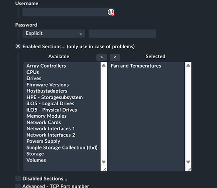

How long does the system needs if you only enable one section like here fan and temperature.
If this time is acceptable then i would do it this way.
You get the system roll-up state and the single fan and temperature services.
In case of an hardware failure beside the fans and temperatures you will get an message at the ā€œSystem stateā€ service.
Hi @andreas-doehler well my first problem is that I am unable to inventory a node with the plugin enabled. Is there an internal timeout in checkmk for that process that will not wait for the plugin to finish and is there a way to increase that timeout?
If you get an timeout only with ā€œFan and Temperaturesā€ active then it needs longer than 60 seconds.
That is normally the check timeout inside CMK.
With enterprise edition you can define your own timeouts for single hosts.
With RAW edition you need to manually change the Nagios core config.
With your system i would do the following steps.
  • define the rule as shown in my screenshot
  • on command line as site user do cmk --debug -vvI hostname
  • look at the needed time - you see this inside output
