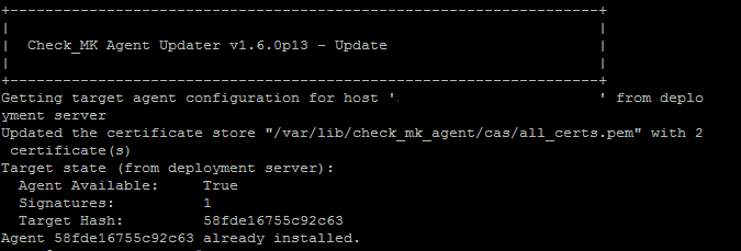

When we look in checkmk server at the host Check_MK Agent check we see a warning
The agent configuration matches the installed one, another cmk-update-agent -v tells us, everything is fine
grafik
What is the problem with the check? We dont see any problem…any ideas?
Kind regards
The “problem” is shown in the last lines from your first screenshot.
There is a Warning/Error from rpm that is no real warning or error.
The note in the next line is the warning from the rpm output. You get also this message if you install this package manually on the system.
I have no workaround for this problem on Redhat/CentOS.
It would be good if you can filter warning or informational messages and only display error there.
