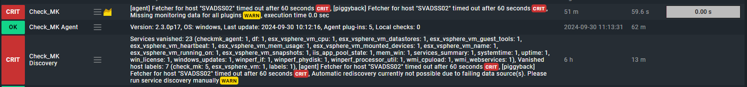

So we’ve been having this problem for a while. Three of the hosts in our DMZ (different network from the one the CMK Server is in) keep going stale in CheckMK, with the following messages:
When that happens, a reboot of the Server in question is sufficient to restore full functionality within CheckMK. Just restarting the CheckMK Service does NOT help.

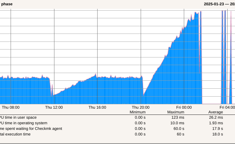

The Graph is also interesting and always looks like this:
So it seems the response time slowly rises until it runs into a timeout?

EDIT: So while typing this I got the idea of testing a higher timeout - that was the reason. The checks with all the plugins took a grand total of 178 seconds! I have no idea why that is the case… any pointers?

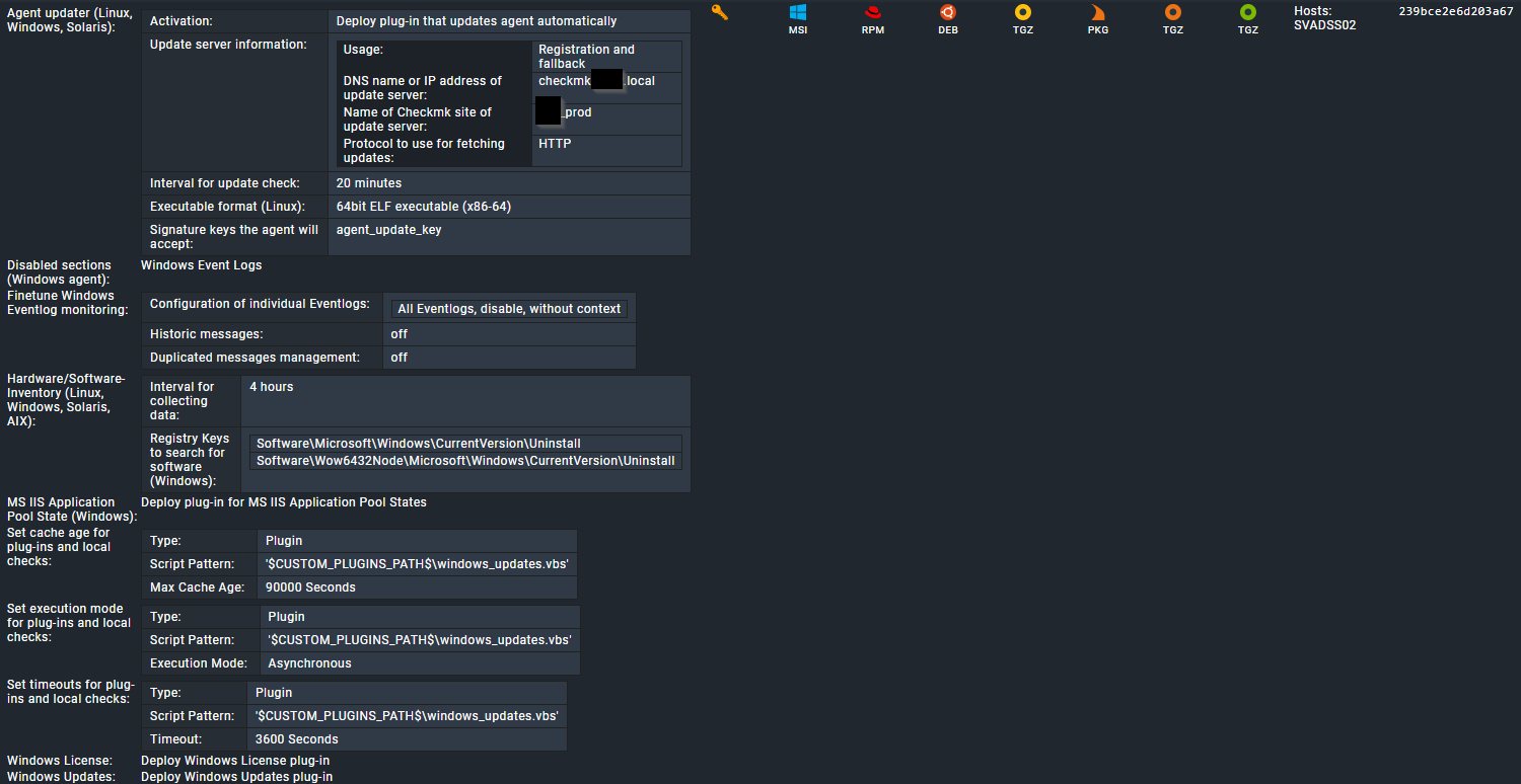

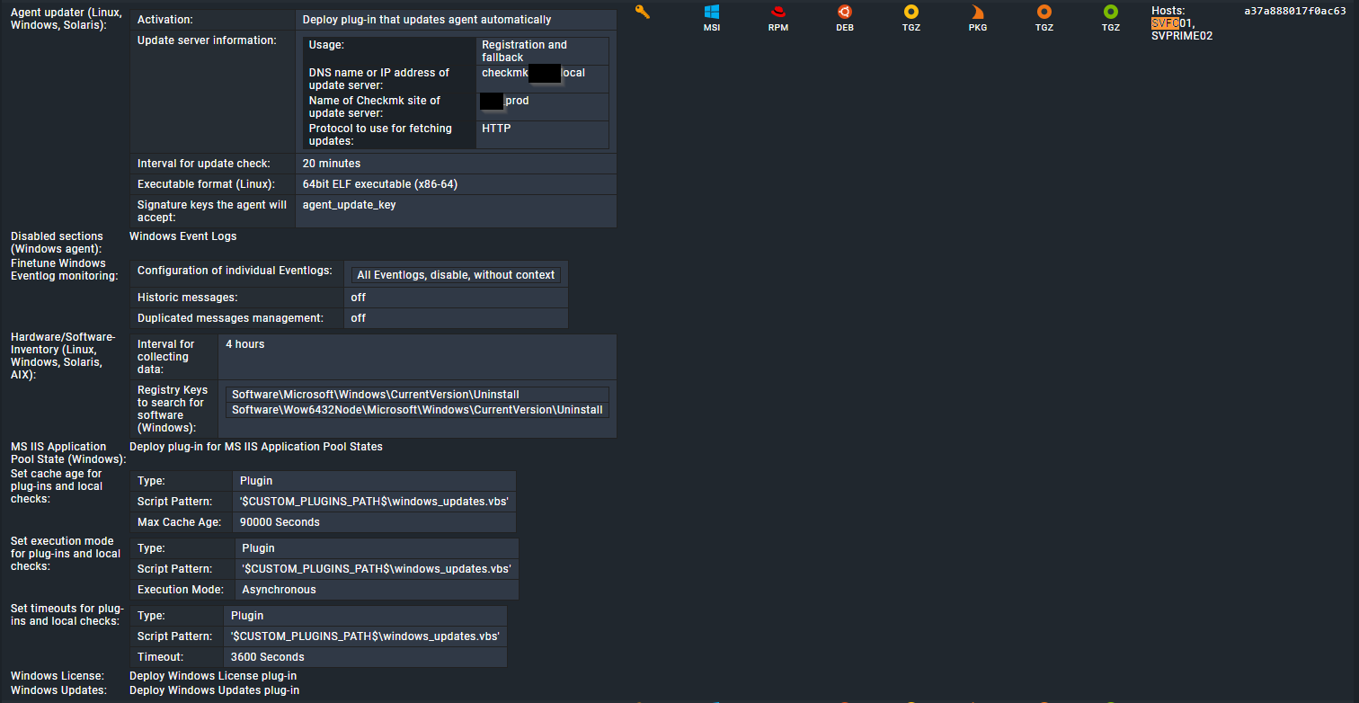

For reference, here’s the config for two of the problem Servers (I have no idea why the bakery seperates these two configs, they are identical!?):
The next step is the agent log on one of the affected machines. There you should see the runtime of one agent query and also what the agent does the whole time.
