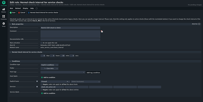

I am struggling to change the check interval for the “Check SSH service” for a single host.
The standard interval is 1min and I need it to be changed to a different value as it is flooding the logs of the target host. (Changing the syslog behavior of the target host is not possible. This is already checked and confirmed)
I managed to change the check interval for ALL active checks for that host, but that is NOT what I want. The interval should only be changed for the SSH Check
What I require is the correct syntax for defining the SSH Check service in the “Conditions”-section.
I could not find the correct service syntax to be used.
Values I tried so far: check_mk_active-ssh, ssh, check_ssh, Check_MK SSH$
Any help is deeply appreciated
Cheers

The name of the service check is usually SSH.
Thx Robert. That did the trick!

Just for completeness, here are the settings:
Proof:
You just look at it in the status view?
yeah, you are right :grinning:
Just a remark as I as Check_MK beginner felt for it: the service name is CASE-SENSITIVE.
So, in my case, I tried ssh (lower case) which did not work.
SSH instead is correct and works
