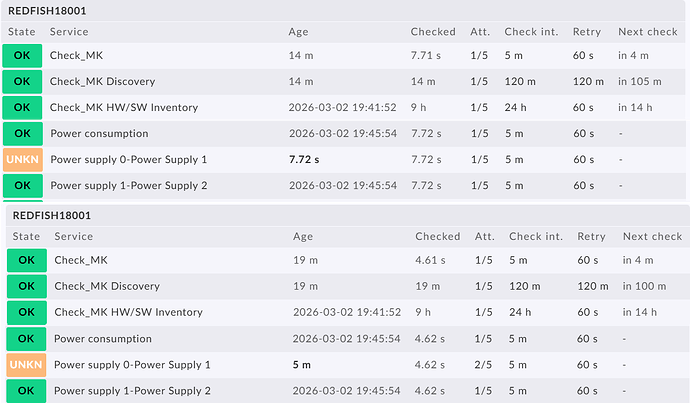

If this is a bug or not is hard to decide :wink: as it is in this state all the time before.
I could simulate your problem in my test system. In my own systems i normally have not this problem as i try to stay with the 1 minute check interval and here also the 1 minute retry.
If i need more check interval then also the retry has the same value.
The following screenshot shows your problem with the one single check that is UNKN and it is a passive check from the CheckMK service on top.
It can be seen that the second check attempt is done 5 minutes after the first one, also with a retry interval of 1 minute.
The only viable solution for this problem would be an alert handler for such a machine that is triggering the Check_MK service in case of an problem with one of the passive services.
Inside the alert handler you can decide then how long it waits before retrying the Check_MK service.
