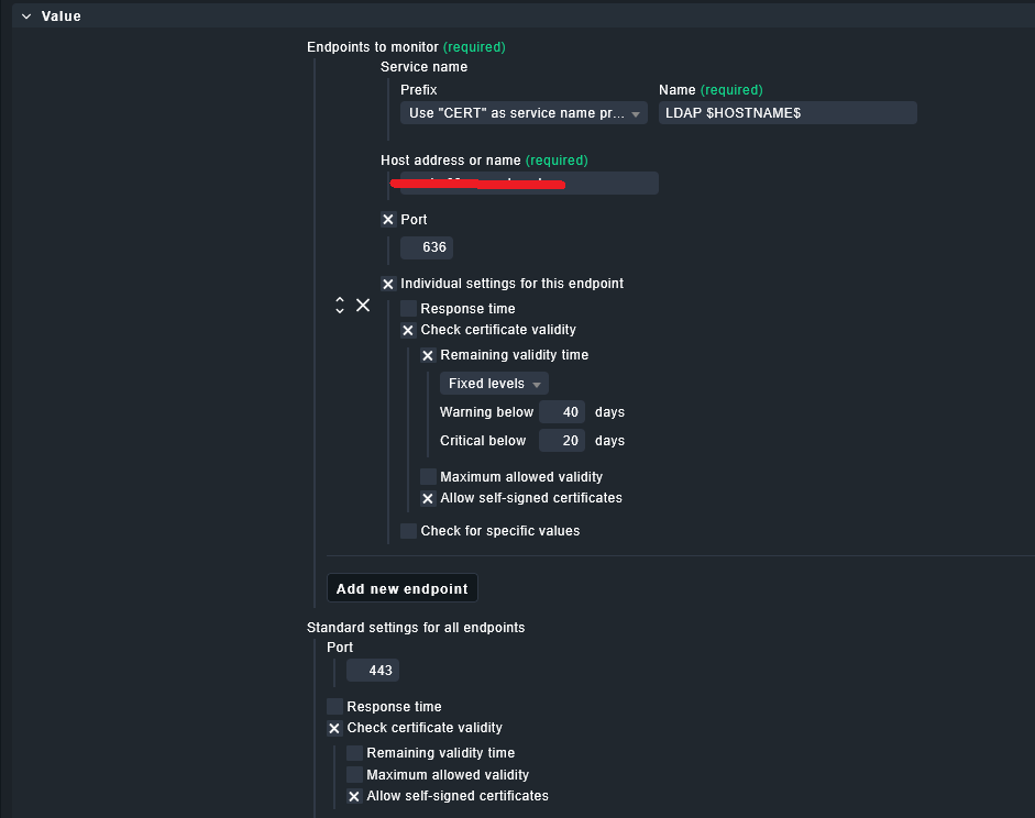

CMK version: 2.3.0p34
OS version: RockyLinux 9.6
Rule configured: Check Certificate(s)
The port used is a/the LDAP(s) port of a server to check its certificate attatched.
Information is correctly retrieved, however it still issues a warning regarding the self-signed part.
Most likely i made a logic error in configuring a/the rule, but fail to see it so i would appreciate some extra eyes.
So what am i missing/not seeing here ?

I have no issues when using a/the rule and having a self-signed on a HTTPS -connection.
As stated above i have one webserver with self-signed certs, and as soon as i ticked ‘allow selfsigned’ it’s warn-state went away.
However for this LDAP(s) its as if the ‘allow self-signed’ - checkbox is not being honored.
So as seen below it keeps complaining about the self-signed -part, even tho the allow self-signed is ticked in the rule.
