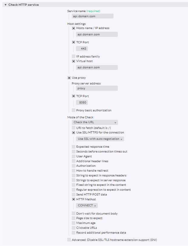

this is how the rule is configured
we managed to fetch the triggered command which look like this:
-u https://website/ --ssl -j CONNECT --sni -p 81 proxy website:443
please note the missing -I and -H arguments in front of proxy and website
i guess this is the issue - the rule somehow forgets to add -H and -I
is there a way we can fix this or is something missing in the rule ?

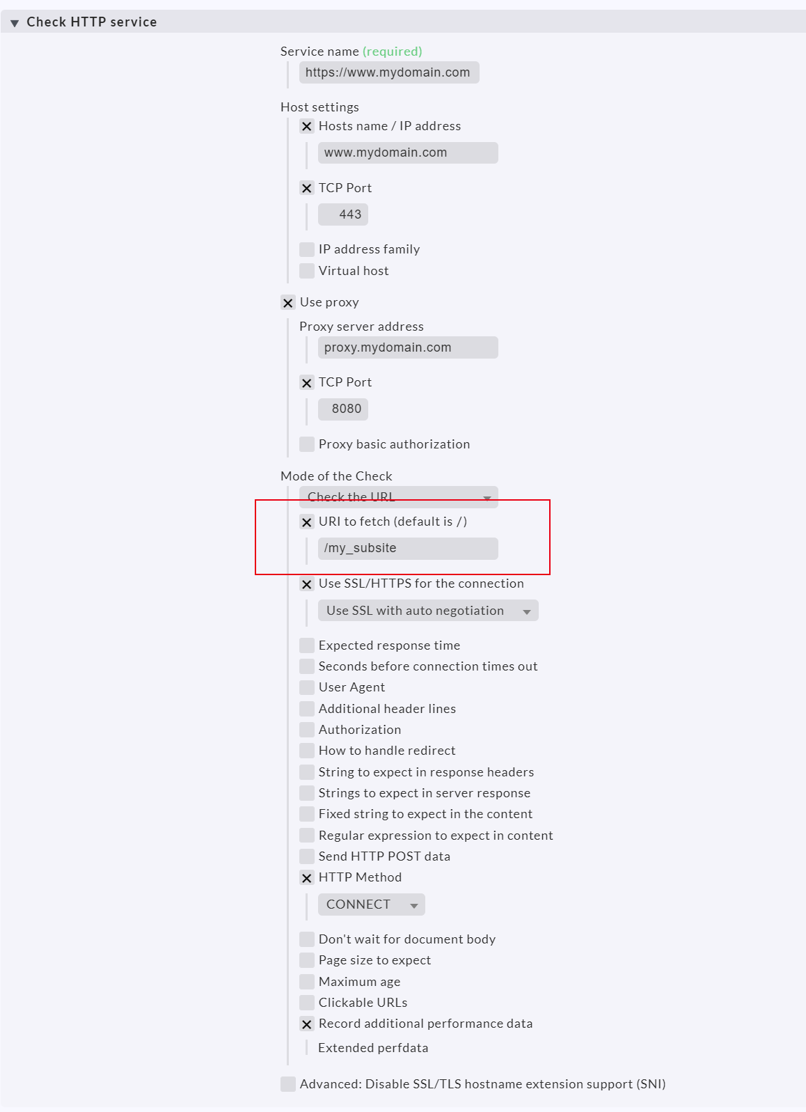

In the URI to fetch you only have to add all after the root “/”, the “https://domain.com” must be removed.
already tested this - does not make any difference
when testing in the command line it also makes no difference if -u is just “/” or the complete url

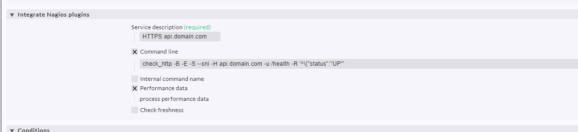

As a workaround you can also call check_http directly via “Integrate Nagios plugins” rule. There you can call the plugin 1:1 like on the command line.
Add the host additionally also in the “Virtual Host” field and try it this way.
the nagios-workaround works fine - thanks for that hint :+1:
we were just focused on the check_http rule so we forgot about such options :roll_eyes:
we can go on with this solution for now - thanks a lot !
i’ve also tried the second option with the virtual host - unfortunately it makes no difference
even the triggered command looks the same - the virtual host option is not executed
for debugging we temporarily replace the check_http command with a own script which logs the command and all of its parameter into a logfile. It looks like the virtual host parameter was not passed to the command at all
or maybe our debugging is wrong - that’s just how we figured it out
a virtual exact copy of our rule just without ssl (port 443) but normal http (port 80) is working fine - but as soon as we activate to use ssl and switch to port 443 the rule is not working
and thats when our debuging shows that -H and -I are missing in the check_http command execution
