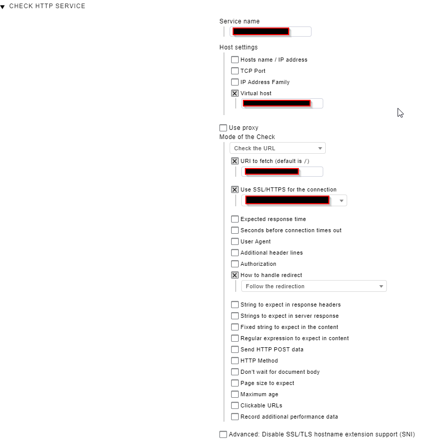

I have configured check_http with check rules - we do not use “virtual host” there. But: since this
update we are getting 404 errors. If I do the same check on the CLI - the check and host is “OK 200”
So if I configure the virtual host in the check rule, all works fine again :frowning: - but I cannot use
variables in “virtual host” right?
Any ideas? Environment: RAW + EE 1.6.0p11

have you ran the exact command that’s shown on the web interface ? if so it’s strange, from cli I only see it working if you had a specified proxy on os, besides that yeah must be check related. Can you share your rule parameters ?
Of course…
only with activated “Virtual host” it’s working. normally I leave it blank here (virtual host) - but if
I do so, I get an 404.
On the CLI: if I use -H it works (its virtual host)
if I use -I it doesn’t work --> 404
OK, got it fixed.
I defined in the check rule unter Virtual Host activated --> “$HOSTNAME$”
Not it works - but documentation mentioned that we should not use virtual host…
any suggestions?
