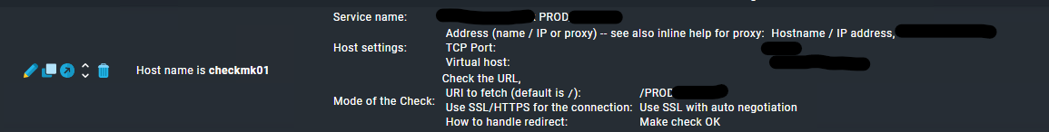

I have created a check HTTP service, like the screenshot.
The website requires login, so I get an Unauthorized, is there a way to change the check, so it just checks if the site is online and ignore the login part_

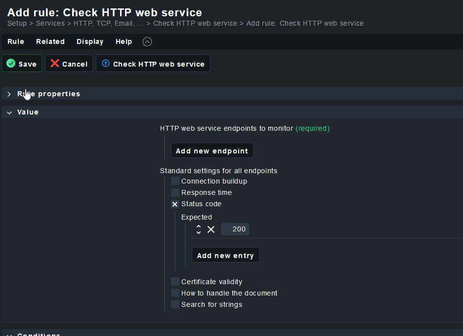

Hi Denis,
the new check_http2 in 2.3 has an extra field for status code:

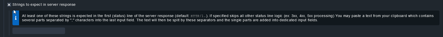

I would suggest using this, with the old check_http you can also build that with the expect option:
Thanks for this.
Will note to change when upgrading to 2.3
Until that the other fix worked, thanks for this.
