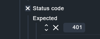

To monitor our websites which requires NTLM authentication, we set the expected status code to 401:
But this is only a workaround. You can not use Content check expressions and you may have failed login attempts in the Logs of the Web Server…
