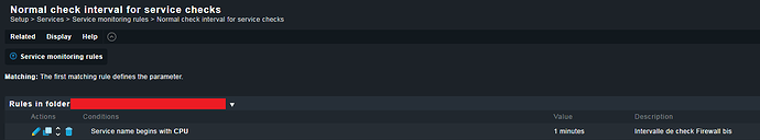

I am monitoring several switches with SNMP and I’d like to modify the check interval for specific checks.
I have created a simple rule in “Normal check interval for service checks” which sets an interval of 1 min for services begining with “CPU”
However this rule seems to be ignored. I tried to remove the condition on the name and the rule did apply on every services wich is a good sign.
What am I doing wrong?
Regards
