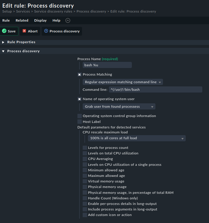

Hi Marcus!
Have you seen the rule Setup→Services→Service discovery rules→Process discovery?
With these settings:
I get these services:
The data stems from the standard ps section which is delivered by the agent anyway, so nothing special must be installed on the agent side.

No. In that field you should enter either the name of the binary (e.g. /usr/bin/lsphp) or a regular expression that matches (the beginning of) the process(es) you want to find (e.g. .*lsphp). The latter will find all processes with some prefix (like /usr/bin/ or /bin/ or /sbin/) and then the string lsphp.
The field is NOT meant for some shell command (like ps …| grep …) that should be run on the client computer to find processes.
If you want to find all lsphp processes, then either write
or
And yes, I assume it will work. It doesn’t differ much from my bash example.

Added rule in ‘Process Discovery’ with these specs:
Process name: httpd %u
Process Matching: .*httpd
Name of operating system user:
Default parameters for detected services: CPU rescale maximum load: 100% is all cores at full load
Levels for process count: 1 processes, 1 processes, 99999 processes, 99999 processes
Levels on total CPU utilization: 90.0%, 98.0%
CPU averaging: 15 minutes
Virtual memory usage: 1000 MiB, 2000 MiB
Virtual memory averaging: 15 minutes
Enable per-process details in long-output: HTML output [! testing
