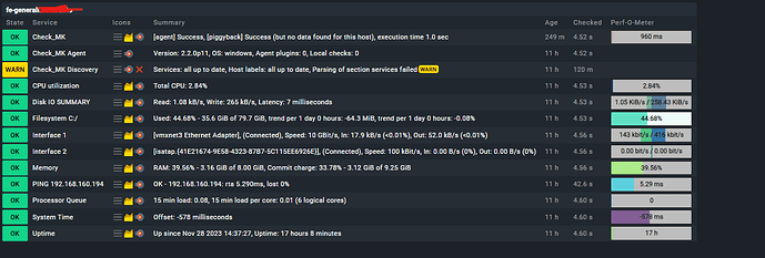

Check_MK Discovery | Parsing of section services failed
I am getting a warning alert in Check_MK Discovery with a status summary as “Parsing of section services failed”

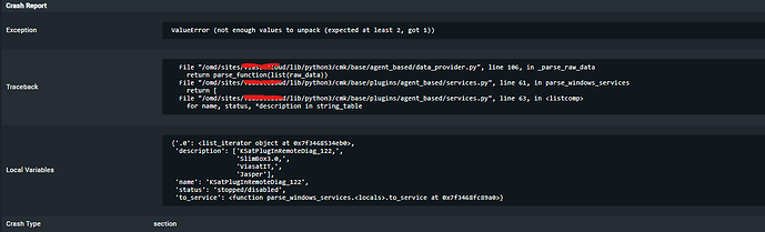

I could see the below error details inside the crash report.
can someone please help me understand the exact cause of this issue?
