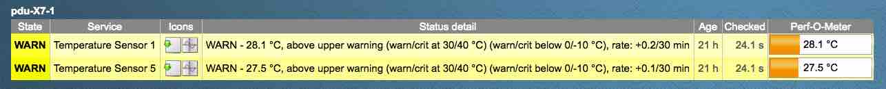

[Check_mk (english)] Can anyone explain why this happens?
Why is checkmk reporting a warning when the temp is below the warning level?

I already did that. That is why it is showing the 30/40c thresholds. I put those in there.

Is this a custom check? If so can you show the script used to see if it clarifies anything?

Not a custom check. I went to hosts, rulesets, then temperature, and changed the rule to set new values and a regex to apply only to these temp sensors.

Ahh, sorry, my fault. Now I understand your issue.
Your Critical lower threshold is at -10°C and the current value is at -28°C. The state should be Critical instead of Warning.
What version of Check_MK are you using.
Is it a Raritan PDU? Or what check plugin is used?

No, no, the value is at 28.1C, positive, not negative. The state should be no warning at all. I am using 1.4.0p8. It’s a raritan PDU and it is reporting correct values. The problem
is in CheckMK.

I believe the problem may be in the chsck script, maybe there is an ‘and’ where an ‘or’ should be…

Where should I go look for this check script?
On Fri, Jul 21, 2017 at 1:16 PM,

On Fri, Jul 21, 2017 at 2:42 PM, JuanEsteban.Jimenez@mdc-berlin.de JuanEsteban.Jimenez@mdc-berlin.de wrote:

It says “check_mk-raritan_px2_sensors”

No worries, you led me directly to the answer. The upper and lower limits are not set in check_mk, they are hardcoded in the PDU.
In other words, not a bug. It’s a feature! Surprise! LOL! :slight_smile:

The check is in /opt/omd/versions/1.4.0p8.cre/share/check_mk/checks/raritan_px2_sensors but with these kinds of scripts I cannot help you… Sorry

You could overwrite that behavior in the temperature rule and use check_mk thresholds from the rule instead.

…and… I just found out that PDU limits and other params are set by putting them into an excel spreadsheet, then in a usb stick that is plugged into the PDU.
The PDU then looks for its Mac address and programs itself on the basis of the info in the sheet. Which means that whomever told me the values are wrong did not remember that those values had been agreed already.
Mfg,

From: checkmk-en [mailto:checkmk-en-bounces@lists.mathias-kettner.de]
On Behalf Of JuanEsteban.Jimenez@mdc-berlin.de
Sent: Freitag, 21. Juli 2017 14:13
To: Gregory Tsintaris; James Harrison via checkmk-en
Subject: Re: [Check_mk (english)] Can anyone explain why this happens?
Allllrightythen! Moving right along to the next item on the checklist…

From:“Jimenez, Juan Esteban” JuanEsteban.Jimenez@mdc-berlin.de
Date: Friday, 21. July 2017 at 14:05
To: Gregory Tsintaris aladou.web@gmail.com, James Harrison via checkmk-en checkmk-en@lists.mathias-kettner.de

**From:**Gregory Tsintaris aladou.web@gmail.com
Date: Friday, 21. July 2017 at 14:00
To: “Jimenez, Juan Esteban” JuanEsteban.Jimenez@mdc-berlin.de
The check is in /opt/omd/versions/1.4.0p8.cre/share/check_mk/checks/ raritan_px2_sensors but with these kinds of scripts I cannot help

See in the service details the Service check
