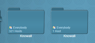

We are starting to automate more with chef which will add nodes to Check mk for us. This is working but the issue we have is that its creating a duplicated folder structure from the one we have in place. Below is after adding a test host
with the API
The folder on the left was created manually but the folder on the right was created when adding a host via the API. Is this expected?
Running check mk RAW 1.4.0P34

Did you create the folder manually with mkdir on OS level?

No we did this through the WATO web interface

I did a quick test:
drwxrwx—. 2 test test 4096 May 24 09:21 za/
drwxr-xr–. 7 test test 4096 Oct 15 2018 ZA/
za is from WATO web gui and ZA is from API

I did think about it being an issue with the capitalization of some of the letters, I copied the folder structure from the web interface and just added the “/” to ensure it was identical

I once run into a similar problem.
I remember it has something to do with the capitalization. You should check your API call for capital letters.

Hi Ryan, please take in to account that what you see on the Web Gui is what you have in the .wato file below the folder:
OMD[test]:~/etc/check_mk/conf.d/wato/local_monitoring/za$ cat .wato
{‘attributes’: {},
‘lock’: False,
‘lock_subfolders’: False,
‘num_hosts’: 0,
‘title’: u’ZA’}
Hope that helps

> I did a quick test:
> drwxrwx---.  2 test test  4096 May 24 09:21 za/
> drwxr-xr--.  7 test test  4096 Oct 15  2018 ZA/
