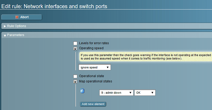

I have a lot of interfaces in the field that are in state ADMIN DOWN
Is it possible to ignore these interfaces, and off course show them again if they become ADMIN UP and OPERATIONAL
Or do I need to do a FULL SCAN when a state changes

Hi Philippe,
using the state mapping of the rule “Network interfaces and switch ports” you sould be able to tolereate “Admin down” ports:
