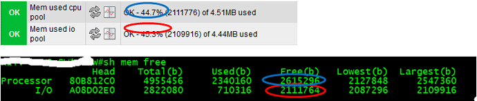

The check (both before and after this patch) appears to report the wrong information, at least in some cases. Instead of “(Mem Used) of Mem Total Used”, it
reports “(Mem Free) of Mem Total used”;

My apologies – after patching, it appears to be right….

Thanks for the testing - i forgot to mention that a re-inventory is needed for the checks as the service description is changed.
As you get a positive result i will submit this now to the feedback email.
Description: C:\Users\Scott\AppData\Local\Temp\SNAGHTMLbebcb12f.PNG
some cases. Instead of “(Mem Used) of Mem Total Used”, it reports “(Mem Free) of Mem Total used”;
