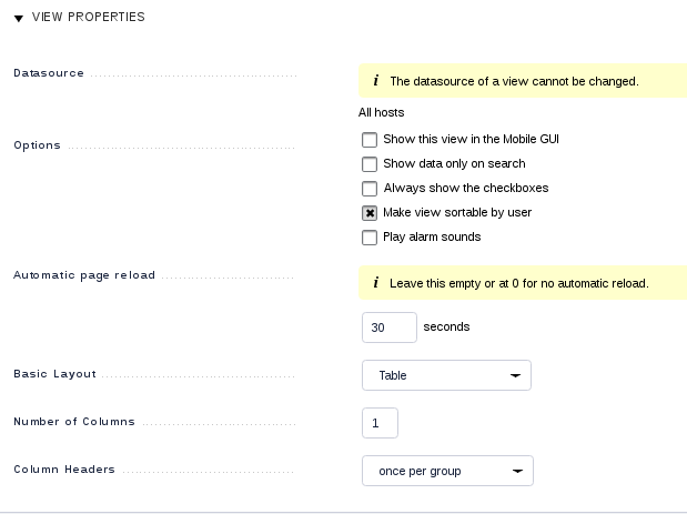

Hello Patrick,
You have a option of Auto-matic page reload when you create a view. Dashboard consists of view.
Correct me if i’m wrong.

On 2 Oct 2019, at 12:05, Praveen Kumar Velpula praveen.velpula@gmail.com wrote:
Hello Patrick,
