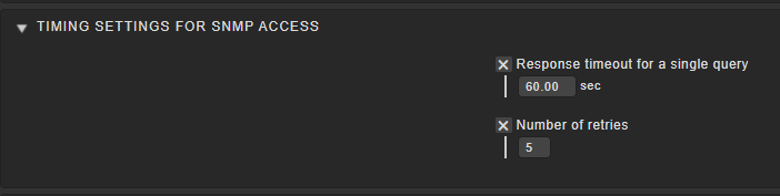

Yes, I actually try to check the time by doing a snmpwalk and it takes over 60 seconds. but when I try to increase this value, in “Time settings for SNMP access”, the maximum is only 60 seconds:
I don’t know if there is another way to change this value, im using a RAW version.
Hi @Gustavo,
As far as I know, you can’t go “higher” than 60 seconds on CRE. On CEE the SNMP part is optimized
in a different way, and has more possibilities.
Thomas

A little bit more clarification to this problem from my side.
The setting @Gustavo posted with the 60 seconds has nothing to do with the real timeout problem.
Sorry to say this. This timeout is used while an SNMPwalk is running inside the SNMPwalk command.
I think if you do an SNMPwalk on your device on the command line it will work without timeout but it takes a very long time.
The relevant timeout for this problem here is the maximum time a check can run before it is terminated by the core.
As we use the RAW edition here with Nagios core you can only modify this setting inside the Nagios configuration files.
The setting what needs to be modified is “service_check_timeout”. The default value is 60 seconds. If you set this to 120 seconds then i would recommend also to set the check interval for the problem hosts to an minimum of 120 seconds from the default of 60. To avoid some race conditions.
