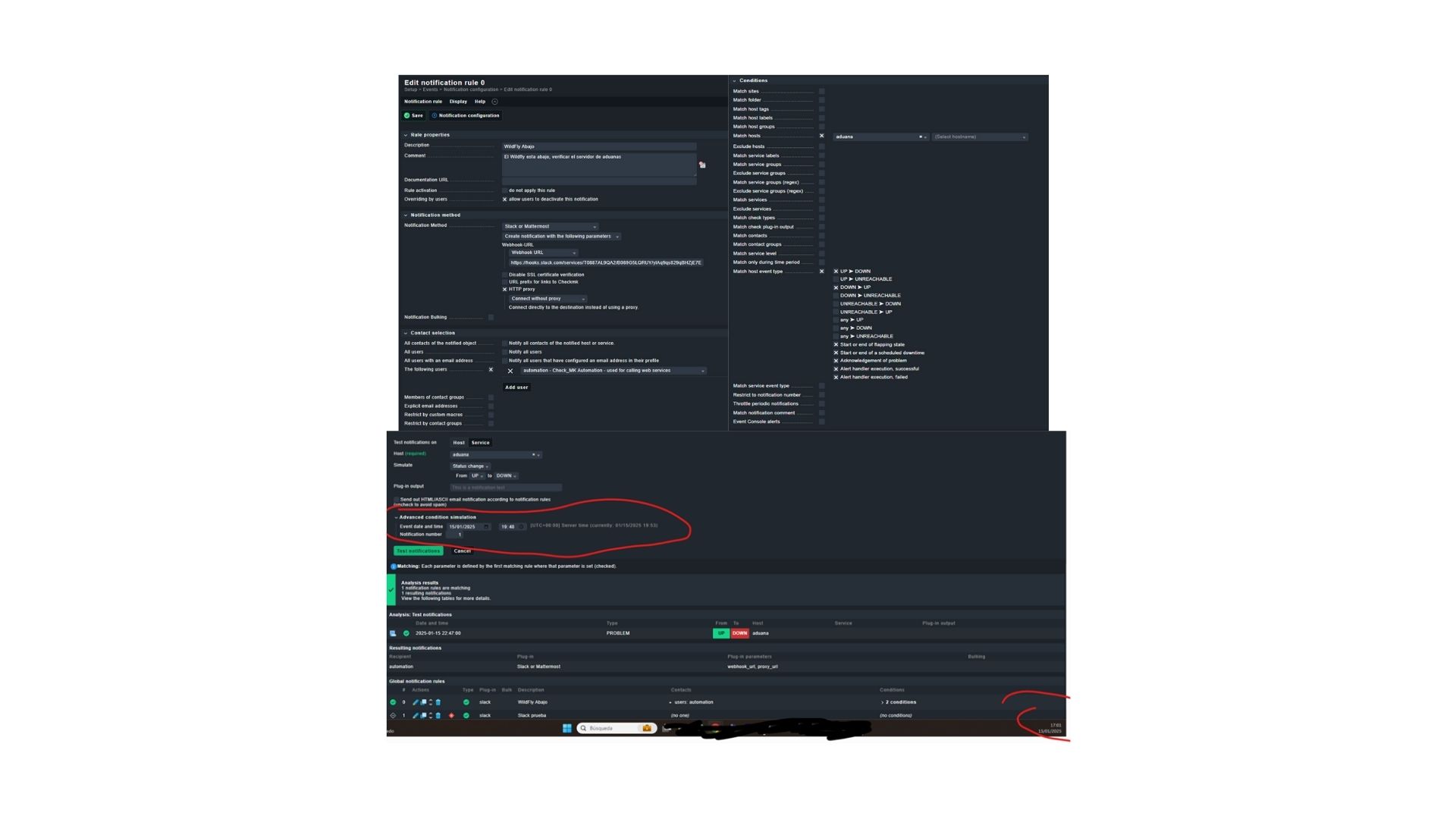

I followed the guide in the docs but am not managing to get the notification in the slack channel, I used the “Test notification” trying different setings

“Test Notification” only works for email, unfortunately.
If you want to test Slack notification, you need to go the ‘traditional’ route of “Fake Check Results”: Commands
From 2.4 on: Werk #17173: Testing notifications: Option to send all notification methods
I tried sending the notifications with fake checks and it works proprerly, thanks Elias and Martin for the resources
