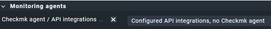

This happen only when those two hosts are configured with API integrations:
All other services on those hosts work perfectly, including [Check_MK inventory] and [Check_MK HW/SW Inventory]

Note: i don’ t use the checkmk agent on almost all monitored hosts.

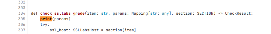

The reason is a evil print statement
inside the file ~/local/lib/python3/cmk_addons/ssl_labs/agent_based/ssllabs_grade.py
If you remove this print line and then save the package with a small different version number, this change will be update safe.
Or you wait for @thl-cmk to build a new mkp :wink:

removing the line the error goes away
(on my checkmk the file is here:
~/local/lib/python3/cmk_addons/plugins/ssl_labs/agent_based/ssllabs_grade.py)
Yeah i forgot the /plugins/ inside the path as i was writing without real system running :smiley:
the fixed version is online now.
