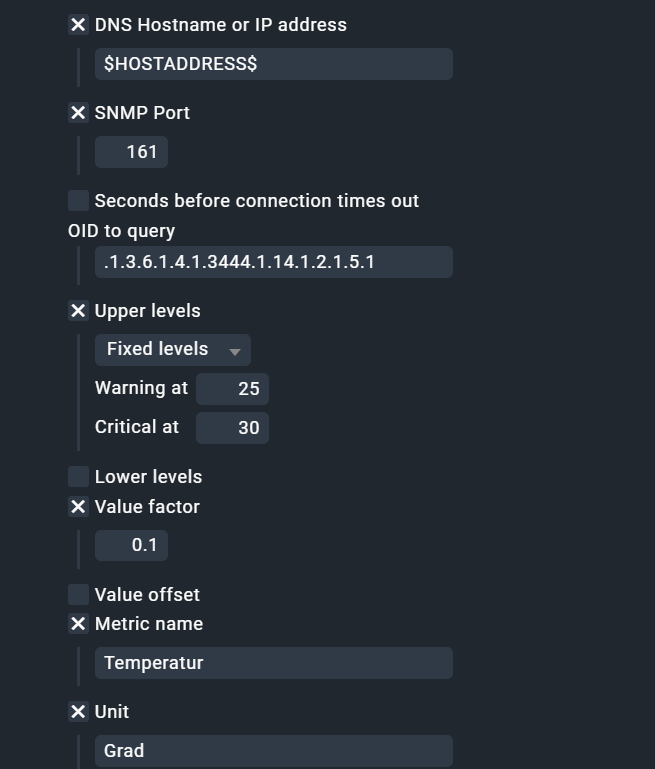

I want to check the OID of one particular sensor. It does work with the Nagios command check_snmp but whatever I enter in the plugin check_snmp_metric it does not show up
My nagios Commandline is:
check_snmp -H $HOSTADDRESS$ -C public -o 1.3.6.1.4.1.3444.1.14.1.2.1.5.1 -P2c -w 25 -c 35 -M 0.1
This ar the settings in the plugin but it never shows a new service:

I’m getting the same issue after upgrading from 2.3.0p34.cce to 2.4.0p9.cce.
The service has disappeared.
we also facing this issue after upgrading from 2.3.0 to 2.4.0p8 during July.
As we are at the beginning of our CheckMK journey we would be very grateful for any help at all
the update of the check snmp metric to v1.1.0 fixed for us the issue that it was not working with checkmk 2.4.
