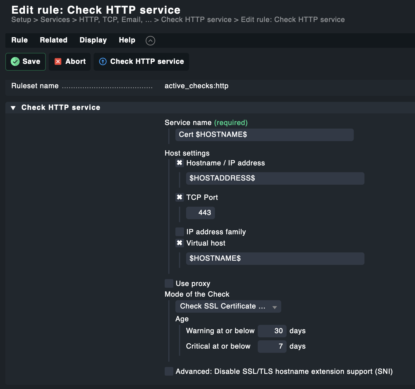

My check configuration:

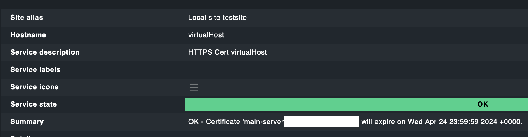

My check result:
Keep in mind, that the certificate ‘main-server.*’ does not cover the domain ‘virtualHost’.

check_http afaik only checks the validity in regards to time, which can change, hence it makes sense to check regularly.
The certificate validity in regards to hostname is fixed, i.e. you would normally notice that it fails the moment you install the certificate and test it with the right hostname/virtual host
Also, the check would then be a lot more difficult as it would include certificate revocation lists and what not.
However; you are not the first one to think about this and someone seems to cover all bases with a separate check plugin here: GitHub - matteocorti/check_ssl_cert: A shell script (that can be used as a Nagios/Icinga plugin) to check an SSL/TLS connection.
