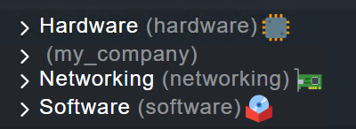

Hello, I started migrating my plugins from Checkmk 2.2 to 2.3 and discovered a change in the inventory tree behavior.
Version 2.2.0p24
Version 2.3.0p9
The same yield statement shows a different structure in the newer version of Checkmk. I want the old behavior. Anyone know how to fix this?

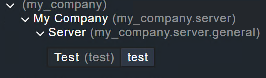

Here only one line is missing. The first screenshot is from 2.3 and the second one from 2.2.
Thank you for the quick reply. I still don’t understand because, in the old version, I didn’t need any display hints or views to achieve the behavior shown in the first picture.
Version 2.3.0p9
As you can see in the picture the new version created a leaf with no title. Is this expected?
Version 2.3.0p9
What happened to the “general” leaf at the end of the attribute path?
If this is expected or not i cannot say.
If i remove my display hints i looks like your example.
Normally every inventory table i use/create has some type of display hints so i don’t saw this behavior before.
I would recommend the display hints, as only with this configured, you can use the resulting table also with filters and sort options.
