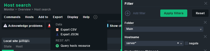

You can use filters in GUI views to make REST API queries easily.
I used view Host search, regex filter on Hostname, select the green suggestion in pull-down based on your regex, Apply filters. When result is what you want, click Export > REST API Query hosts resource
Example above results in link:
Or URL encoded:
https://[server]/[site]/check_mk/api/1.0/domain-types/host/collections/all?query=%7B%22op%22%3A+%22~~%22%2C+%22left%22%3A+%22hosts.name%22%2C+%22right%22%3A+%22server%2A%22%7D
I’m using 2.1.0p5 raw. There have been changes with REST API after that, so best to create your own query by GUI to be sure, and not take my shown results.
The regex query image is done by Livestatus.
