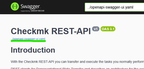

CheckMK 2.5 Swagger Yaml File Returns 404 on download
CMK version: Checkmk Ultimate with multi-tenancy (formerly MSP) 2.5.0
OS version: RHEL 9.7(plow)
Error message: 404 Error when clicking or attempting to download the ../openapi-swagger-ui.yaml file from the interactive gui page.
Steps to reproduce:
  1. Login to site
  2. Click Help > REST API > Version 1 Interactive GUI
  3. New Swagger site/tab loads //check_mk/api/1.0/ui/
  4. Click on ../openapi-swagger-ui.yaml hyperlink
  5. Receive a 404
Also I should note that the Click Help > REST API > Version 1 Documentation Link opens
//check_mk/api/doc/ but the “Download” link there does pull/save “openapi-doc.yaml”.

Hi @scotsie,
the Team fixed this with https://checkmk.com/werk/19883, which will be released with 2.5.0p8.
