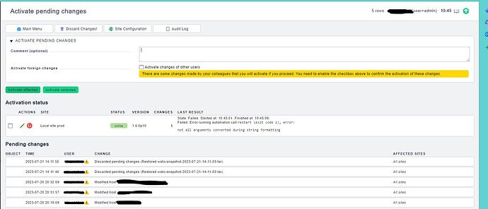

In CheckMK Gui, I am trying to disable a Router for monitoring. Steps taken in CheckMK Portal :
  1. In the Views → Hosts → All Hosts, I clicked and selected a host that needs to be disabled
  2. After selecting the Host, I went to WATO → Custom Attributes → Criticality tick box–> selected
    “Do not monitor this host” from drop down menu.
  3. Performed “Activate the Pending changes” and also ticked “Activate changes of other users”, it
    does not work. Received error as below in the Activation Status:
    State: Failed. Started at: 14:50:24. Finished at: 14:50:29.
    Failed: Error running automation call restart (exit code 1), error:
    not all arguments converted during string formatting
I have attached a screenshot of the error shown. May I get some advice if I have missed any steps above, or if there’s a different method of disabling a router from
monitoring?

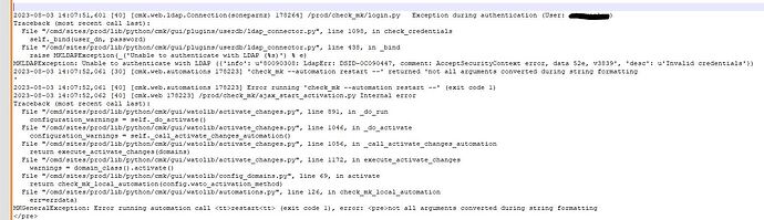

I don’t have cmc.log file but did check web.log. Seems like issue related to invalid credentials and checkMk automation restart goes into error. Is there a way to check which username used to configure routers and Parent routers in CheckMK?
Attach is the screenhsot of the error from web.log
, any recommendation to investigate this further would be great.
