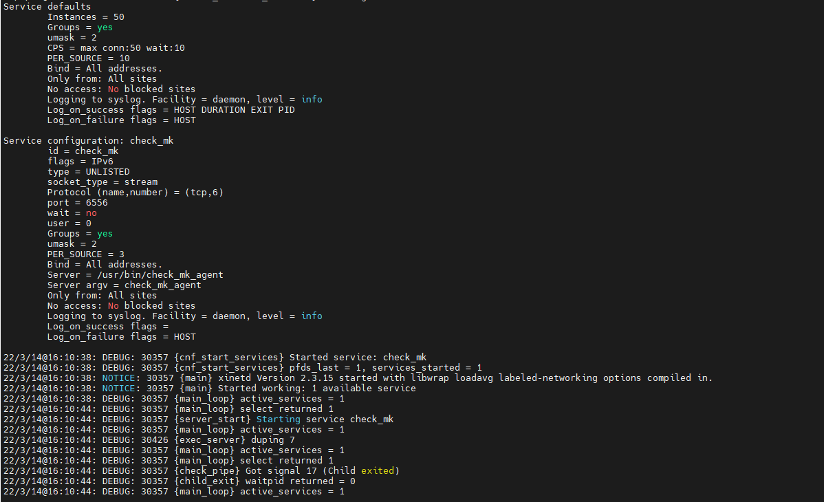

This is the output of xinetd -d:

You probably need stop the normal xinetd first before starting a debug instance.
