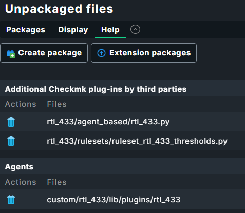

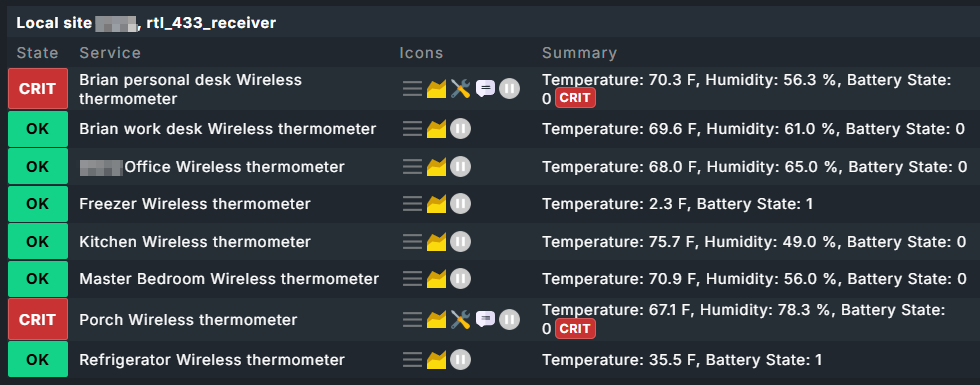

I am using generic 433 MHz wireless thermometers, and a software defined radio passed through to an LXC container that listens to their beacons. A custom Python script turns the beacons into files that a Checkmk local agent plugin scrapes on poll. Finally, that data is ingested by a custom agent_based.v2 plugin allowing me to run a service discovery and choose which thermometers I want to monitor or disable from the UI.

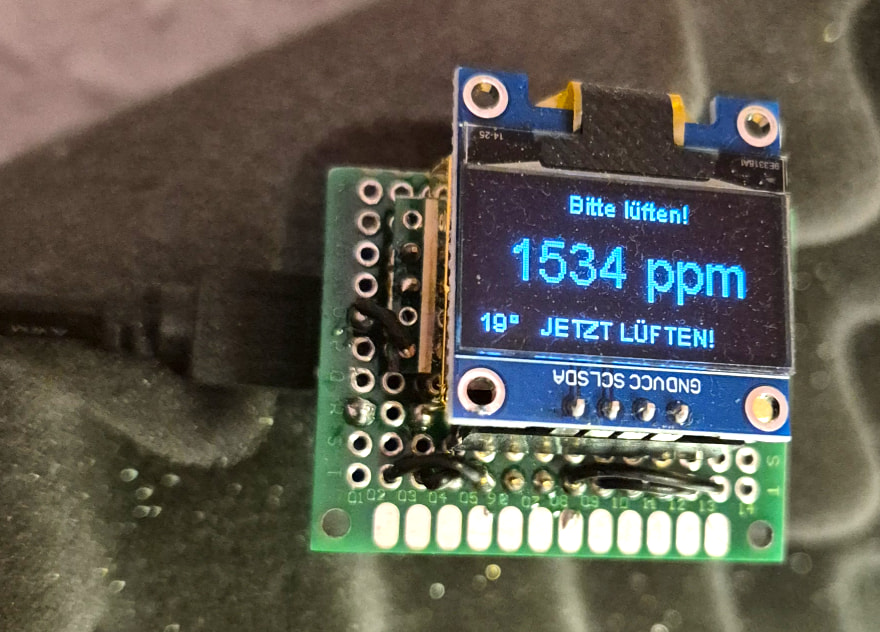

  • I, too, have (selfmade) CO2 sensor devices, using MH-Z19B sensors and ESP32s. These have displays and RGB LED rings to indicate CO2 levels and also log the data to a database. I use my personal CMK to alert me when it’s time to let some fresh air in. Here’s a small version:

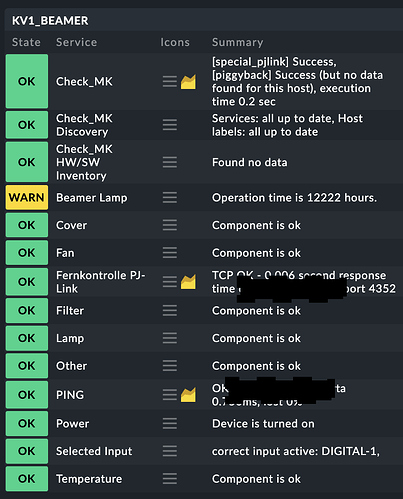

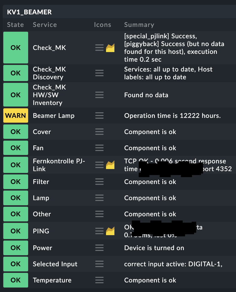

I’ve made a special agent for video projectors (“beamer”) with lamps etc. That uses the PJLink protocol (my fork of the lib is here: GitHub - FlorianHeigl/pypjlink: PJLink is a standard for controlling data projectors. · GitHub , and I uploaded the agent as a gist: PJ-Link special agent · GitHub (i’m sorry that I can’t tell you if it’s the latest version, my memory is very bad))

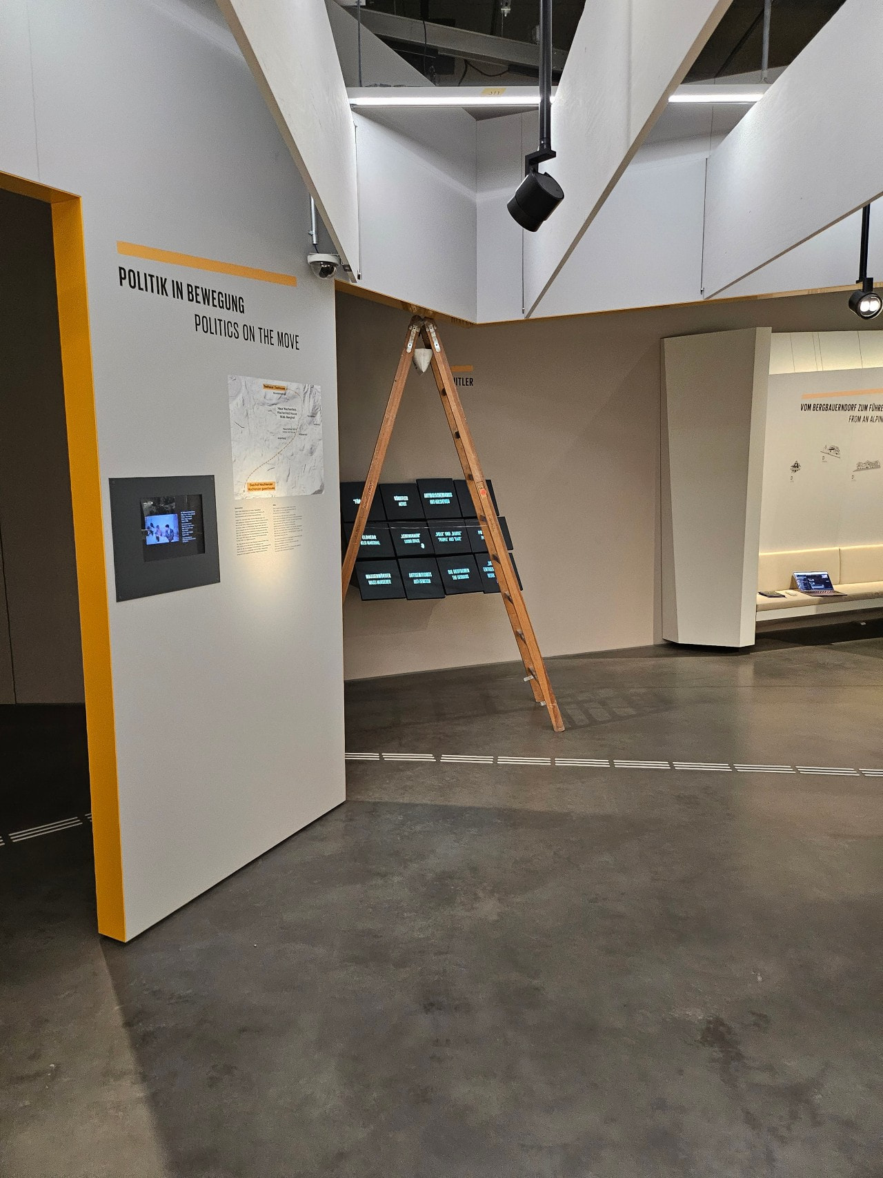

Those are the shiny blinky things at Dokumentation Obersalzberg, basically the CheckMK monitoring is watching the status of the old bunker of Hitlers holiday residence :slight_smile:
Silly fact: Due to the contents when a projector is to be picked up for repair we give them different less offensive names on the UPS shipping label :slight_smile:
