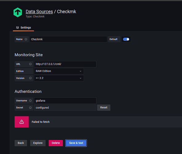

Checkmk data source API problem
CMK version: 2.2.0p23.cre
OS version: Ubuntu 22.04
Error message: INFO [07-01|12:51:43] Request Completed logger=context userId=1 orgId=1 uname=admin method=GET path=/api/datasources/proxy/uid/edqfmqmdgpm2oc/rest/check_mk/api/1.0/version status=404 remote_addr=192.168.65.1 time_ms=6 duration=6.871103ms size=196 referer=http://localhost:3000/connections/datasources/edit/edqfmqmdgpm2oc handler=/api/datasources/proxy/uid/:uid/* status_source=server
I’m encountering an issue with the REST API; they are telling me there might be a problem with the versions or the edition of Checkmk. I tried getting the latest version of the Grafana Checkmk Datasource plugin, version 3.3.0 (more precisely this plugin: https://github.com/Checkmk/grafana-checkmk-datasource/releases/download/v3.3.0/tribe-29-checkmk-datasource-3.3.0.zip) . Despite this, it seems that the API route isn’t up-to-date. Consequently, I’m unable to connect my Checkmk server to Grafana v11.1.0.
Should I wait for a plugin update? Or is there possibly an error in how I’m setting things up?
Thanks.
Hello
Please, check your config. It seems you are using Checkmk 2.2.0p23 Raw edition (cre), so you must fill this information:
URL: http:///
Edition: Raw Edition
Version: >= 2.2
Also check the credentials you are using.

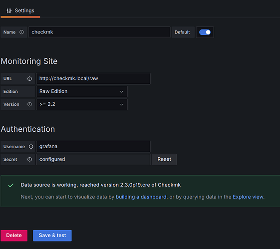

I’ve tried to connect Checkmk Raw Edition 2.3.0p19 to the latest version of the Grafana plugin and there is no issue.
Please check the following:
  • The connection between Grafana and Checkmk, especially if any of them is running from docker
  • There is no firewall interrupting the communication.
  • The user grafana has administrator permissions
  • Grafana’s logs
  • Checkmk logs (~/var/log/web.log, ~/var/log/apache/access.log, ~/var/log/apache/error.log)
I was following the Checkmk Grafana Integration documentation and identified a key issue: the address for the Checkmk data source must include the port 5000 in the format http://127.0.0.1:5000/<checkmk_site>. Additionally, Grafana must be running on the same server as Checkmk for the integration to work; otherwise, it won’t function.
This requirement is also highlighted in the plugin development documentation: Grafana Checkmk Datasource Plugin Development Guide.
Moreover, you’ll need to set several environment variables for proper operation. These can either be exported directly in your environment or defined in a .env file for convenience.
