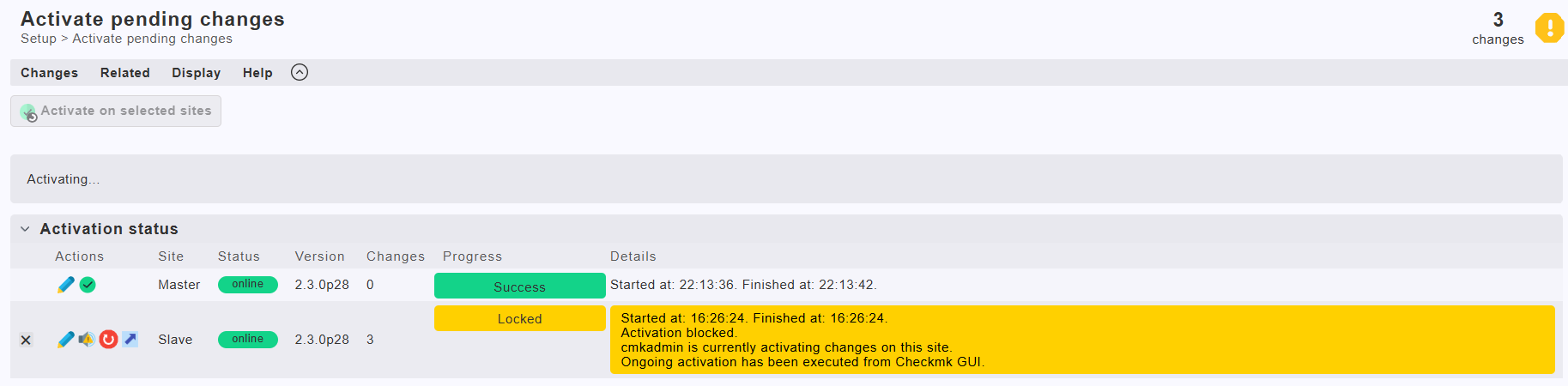

The issue involves a distributed monitoring setup where activating changes fails, affecting configuration replication and causing monitoring disruptions.
Current Setup:
Version: Checkmk Managed Services Edition 2.3.0p28
Monitoring Mode: Distributed Monitoring (Primary & Secondary) - Working as expected
Issue: No activate any changes between Primary y Secondary servers

Hi dtuecks
Thank you for your suggestion. I followed your steps, but unfortunately, the solution wasn’t viable.
I ran the commands you provided:
  1. cmk --debug -Rvv to reload the site with debug options, but the issue wasn’t resolved.
  2. I tried restarting the slave site with omd restart, but the problem still persists.
  3. I also checked the ~/tmp/check_mk/wato/activation/ directory, and I didn’t find any old directories that could be causing the issue.
Could you suggest any other alternatives or additional steps I could try to fix it?

Hello Community,
Current Configuration:
Monitoring Mode: Distributed Monitoring (Primary and Secondary) – Operating as expected
Issue: Changes are not being triggered between the primary and secondary servers.
Regarding this issue, it has been confirmed that the Cortex Security Agent is preventing CheckMK from functioning properly.
