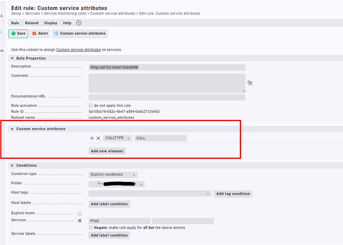

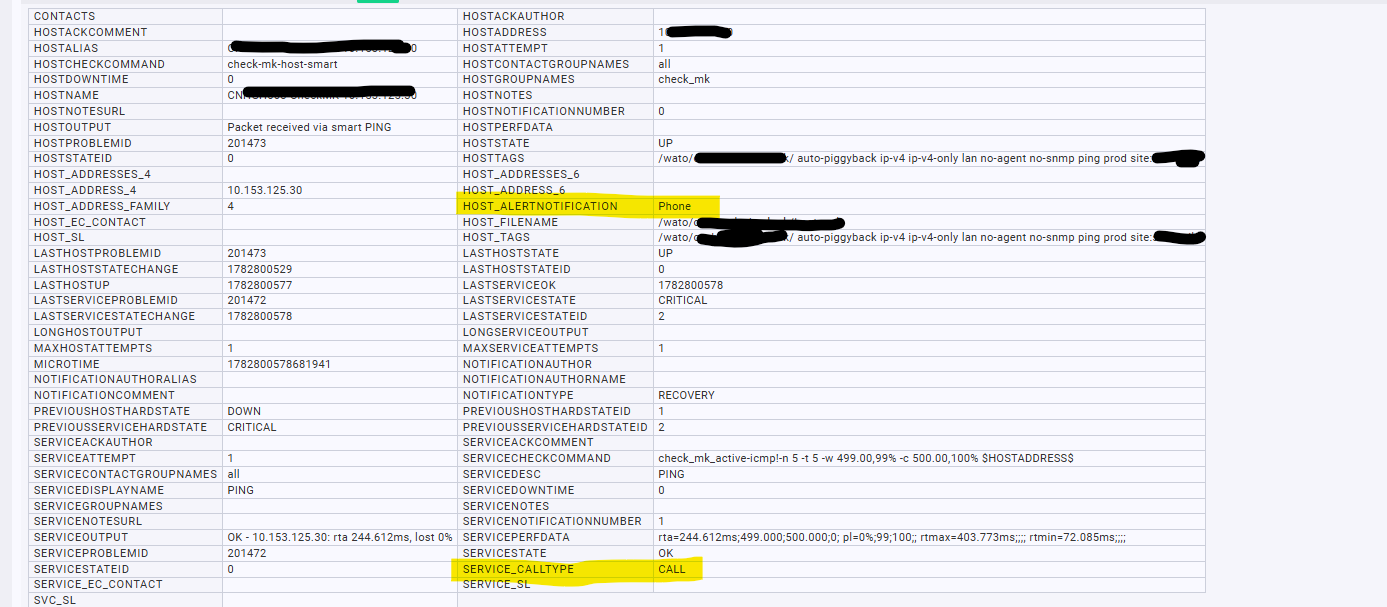

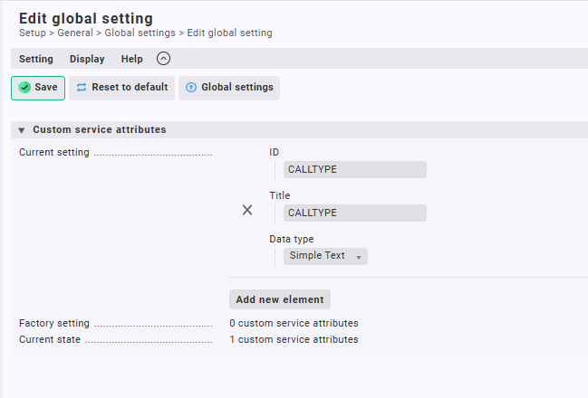

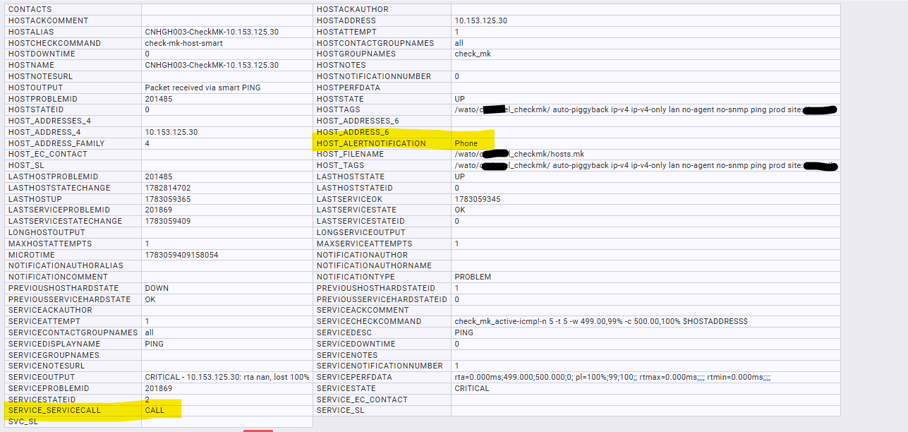

I am using CheckMK enterprise edition 2.1.0p16, and I use my notification script checkmk_call.py for sending notification to remote mail server, I created 1 custom host attribute named “alertnotification” and 1 custom service attribute named “CALLTYPE” , and I 've added these 2 attribute to my CheckMK_call.py and the check_mk_templates.cfg file under /omd/sites/yoursite/etc/nagios/conf.d/ as below, so that it can be passed to my remote mail server. But only the host attribute “alertnotification” can be passed onto remote mail server, but the “CALLTYPE” service attribute can not, although I checked the Recent notifications (for analysis) that both attribute values are listed as highlighted in yellow. MeanWhile I 've another Checkmk in community edition 2.4.0p24 have exactly same setting , it works well which can send both “alertnotification” and “CALLTYPE” value to remote mail server. It’s looks in 2.1.0p16 there is issue for sending the custom service attribute ?

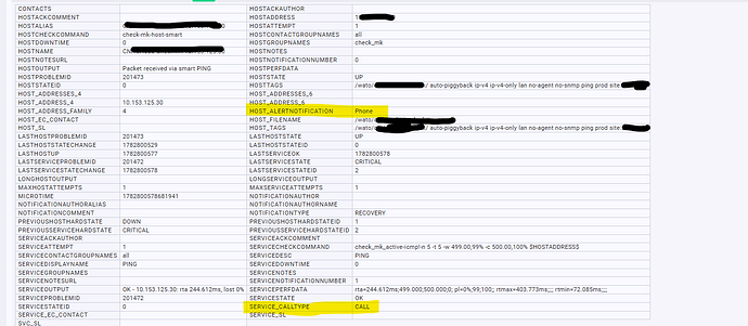

If you see the “SERVICE_CALLTYPE” in the recent notifications then you can also access this variable as environment variable from your script.
What do you see if your notification script dumps the whole context of such a notification? There you should see the same variables as in your screenshot of the recent notifications.

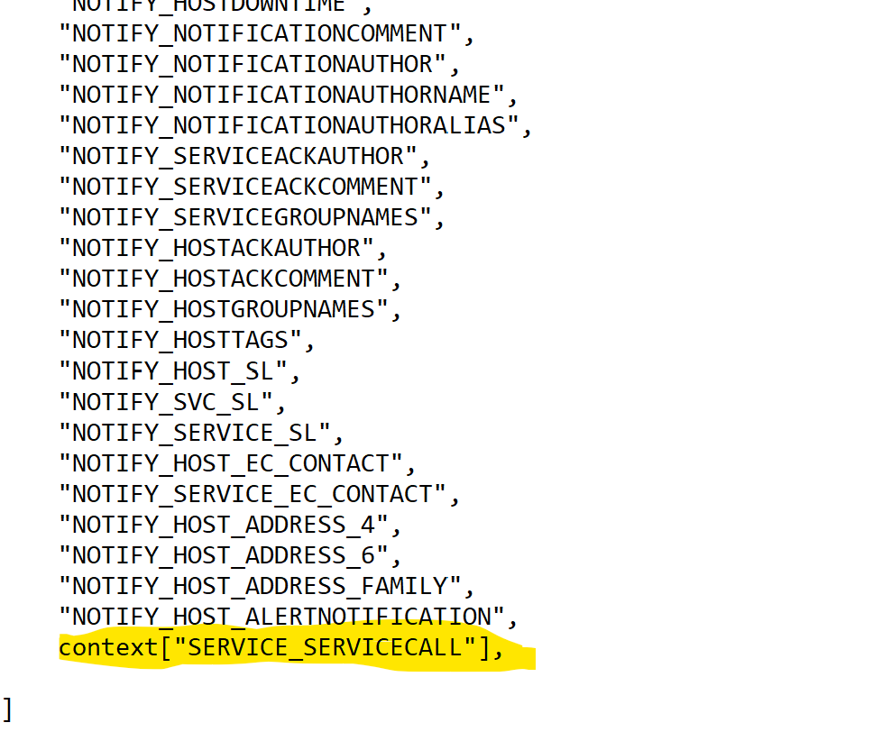

HI Andreas, this is my checkmk_call script, hope you can help check it works or not.
The script works in Community 2.4.0, but in my Enterprise edition 2.1, it can send the host attribute “NOTIFY_HOST_ALERTNOTIFICATION” but not the service attribute "“NOTIFY_CALLTYPE”.
As I don’t know if it’s caused by the editon 2.1 is too low or other reason, so I am afraid even I upgrade it to a higher version it still not fixing the issue.

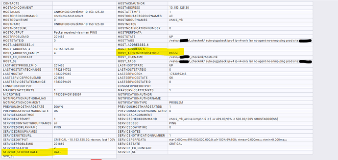

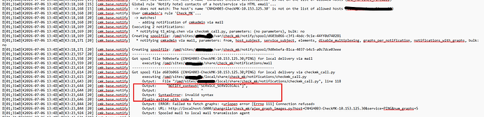

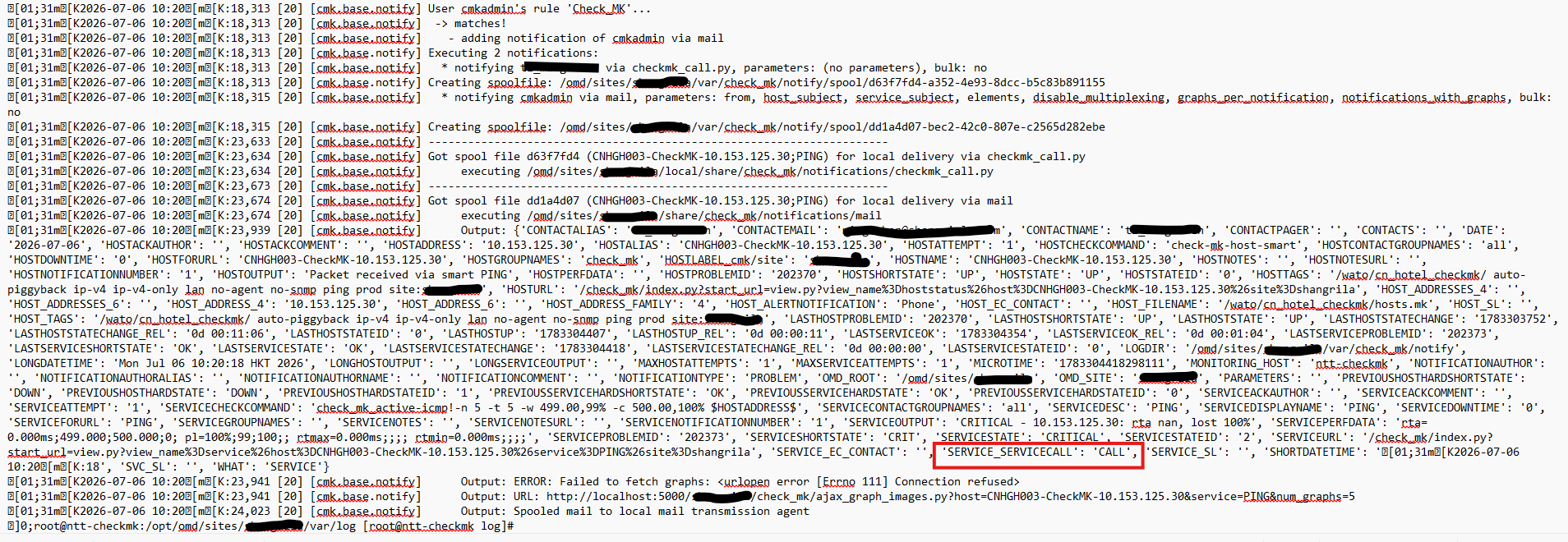

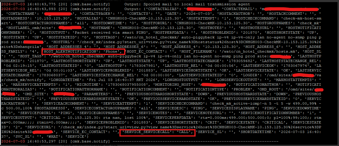

here you go, this is the output I found in the notify.log file , I can see both “alertnotificaiton” and “servicecall” attributes. Please advise . thanks !

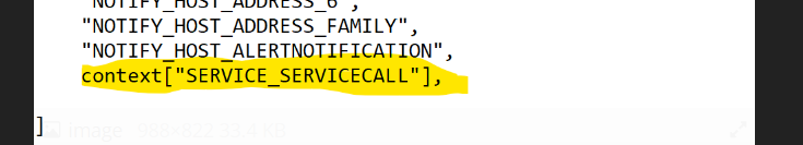

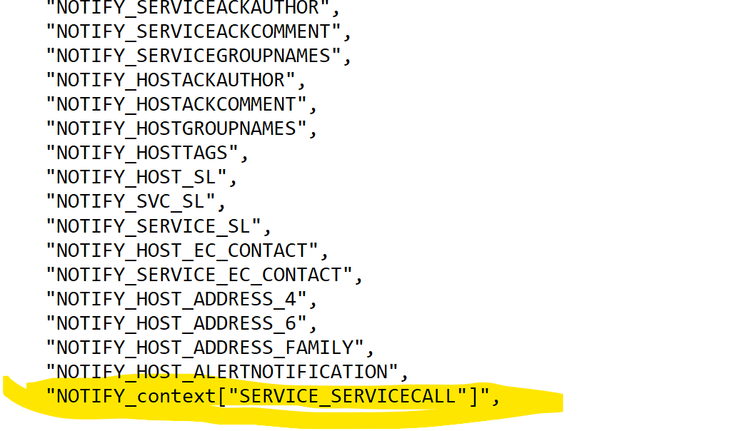

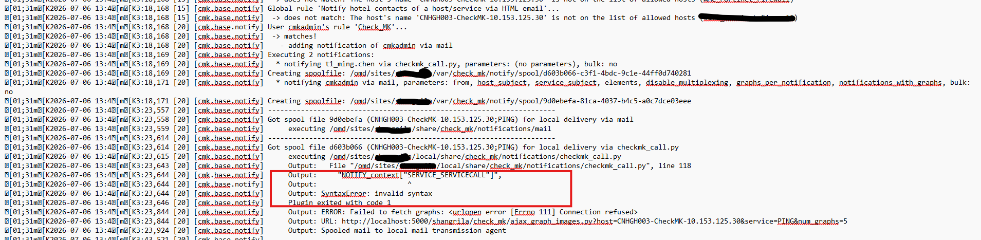

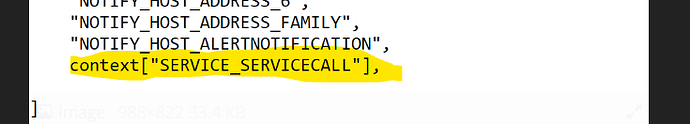

Thanks, I’ve tried the following, but still not work,Please help . Thanks a lot!
1. I added the line context[“SERVICE_SERVICECALL”] into my script , in the notify.log, can see the “service_servicecall”, but remote site still can’t receive the attribute.
and that
forget the variable list - this is obsolete code that is not used anywhere anymore.
from cmk.notification_plugins import utils
context = utils.collect_context()
service_notify_typ = context["SERVICE_SERVICECALL"]
then you can do something with your variable inside the code.
In your script i don’t see any location that is using the variables that you try to define inside the macro list.

The problem is that community edition works completely different.
Community → Nagios core with definition of used variables inside config files
Enterprise → CMC core all variables are existing inside the environment and can be used with the mentioned script lines
For the community edition you need to extend the Nagios template config with the variables. “NOTIFY_SERVICE_SERVICECALL” and “NOTIFY_HOST_ALERTNOTIFICATION”
Later inside the script you can then reference the variables inside enterprise and community the same way.
Output all the context one time on a community edition system and one time on the enterprise system. You should see the two variables on both context outputs.
