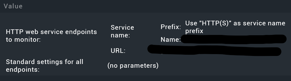

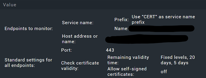

Here are the monitoring rules I’ve configured:
CERT
HTTPS

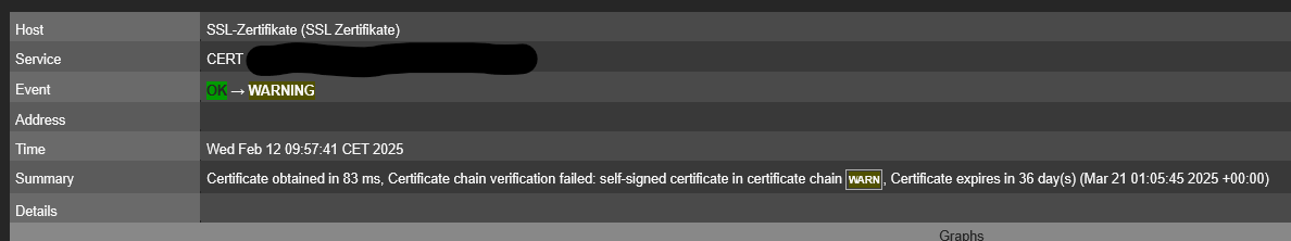

However, I receive daily notifications from Checkmk with the following message:
Summary Certificate obtained in 59 ms, Certificate chain verification failed: self-signed certificate in certificate chain WARN , Certificate expires in 36 day(s) (Mar 21 01:05:45 2025 +00:00)

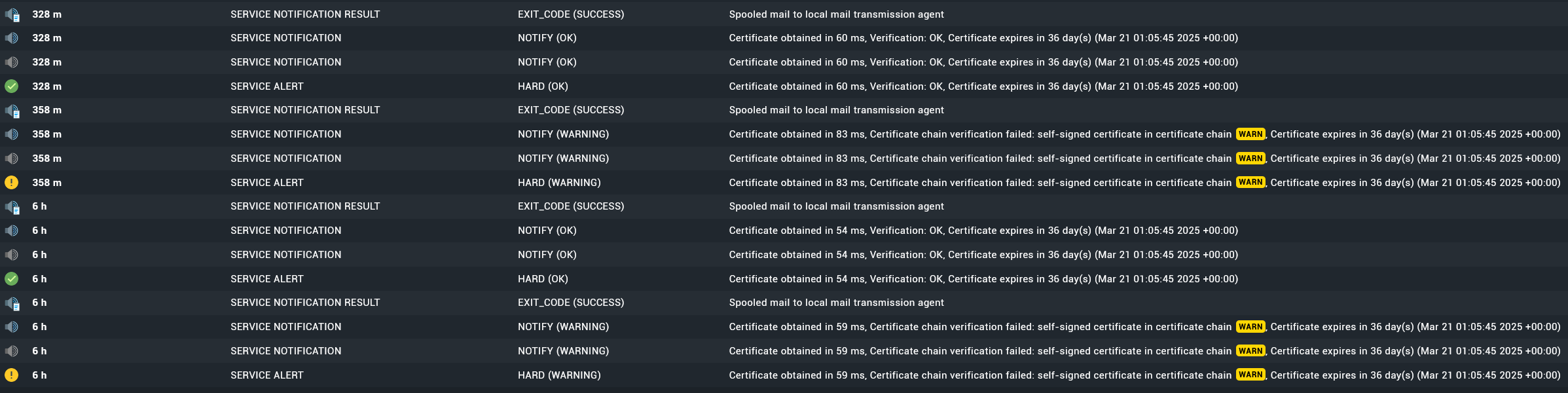

A few minutes to half an hour later, I receive an “OK” notification:

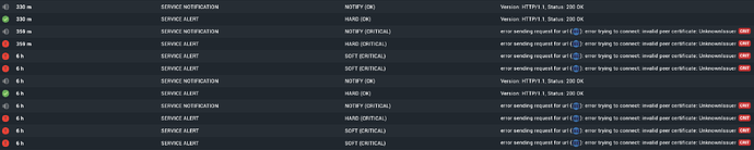

This happens every day for both the HTTPS and CERT rules.
The website is always accessible and the certificate appears valid when I check it, but I still receive these errors. Neither I nor any customers have experienced connectivity issues with the web application.
