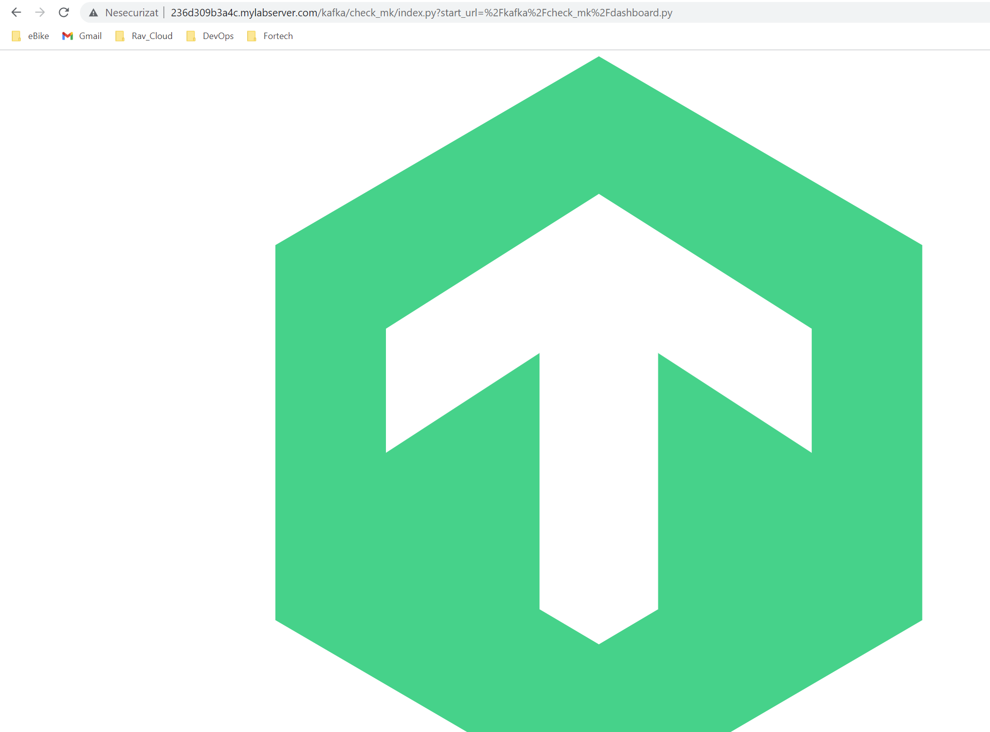

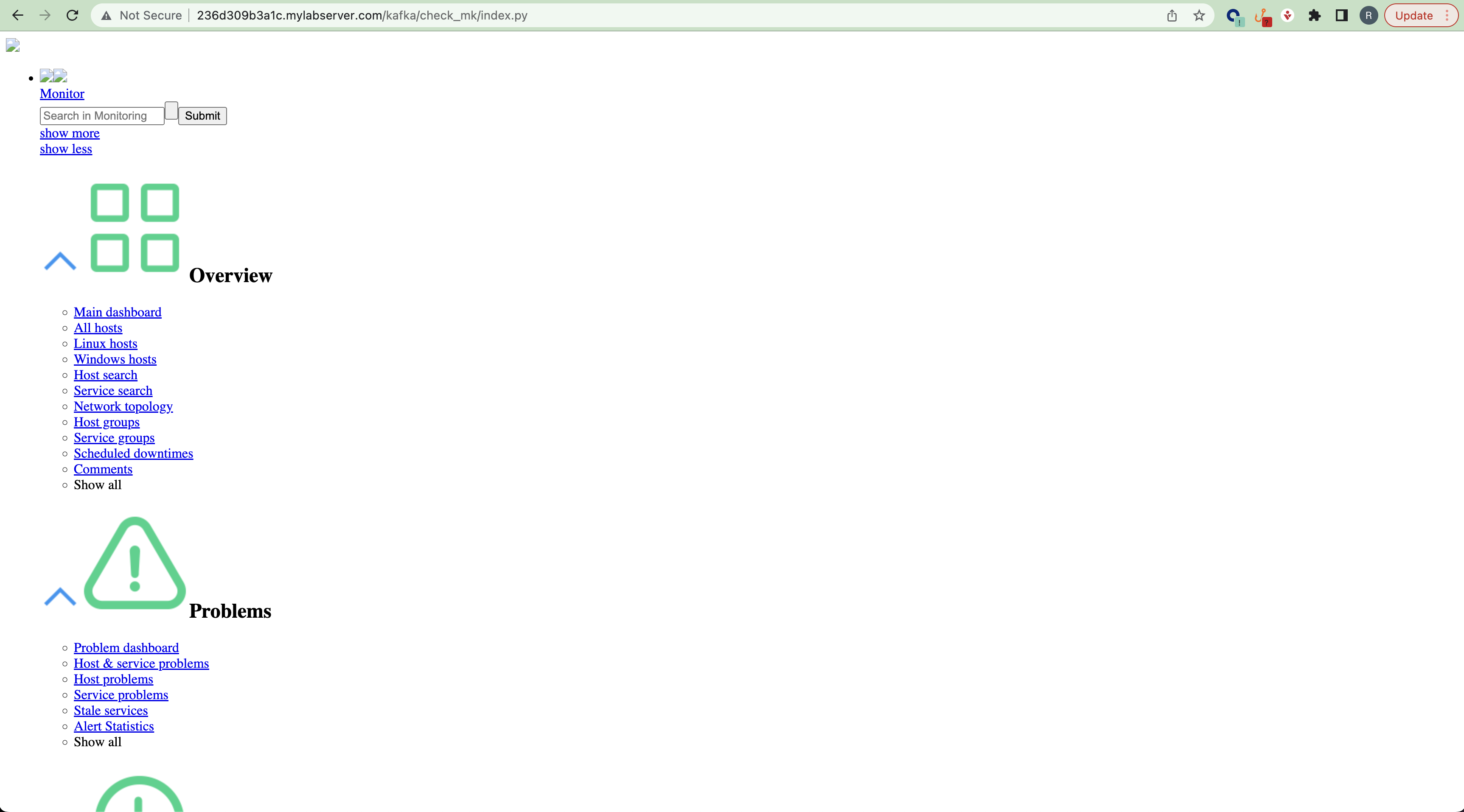

Checkmk page not loading properly
CMK version: OMD - Open Monitoring Distribution Version 2.1.0p9.cfe
OS version: CentOS 7
Page not loaded properly

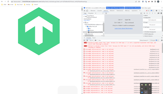

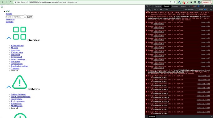

Refused to execute script from ‘http://236d309b3a1c.mylabserver.com/kafka/check_mk/js/side_min-2.1.0p9.js’ because its MIME type (‘’) is not executable, and strict MIME type checking is enabled.
Can you provide a little more insight, than this cryptic messages?

Hm, I get the hunch, that there is a web application or next generation firewall in between.
Does this issue happen on several clients and browsers, or only on yours?
I tested with firefox, chrome, safari, the result is the same.
In the firewall http service ia allowed.
The setsebool for httpd_can_network_connect is set to 1.
I have disabled the firewall still the same issue.
What happens with a clean and fresh Firefox without any add-ons?
I do not belive it is a browser issue.
The issue is present in, chrome, firefox, edge and safari.
I found this here: How to disable strict MIME type checking? | SonicWall
Maybe it is your firewall after all?
The link doesn’t help me.
I have changed the OS to ubuntu 20.04 LTS, and the issue is stil present.

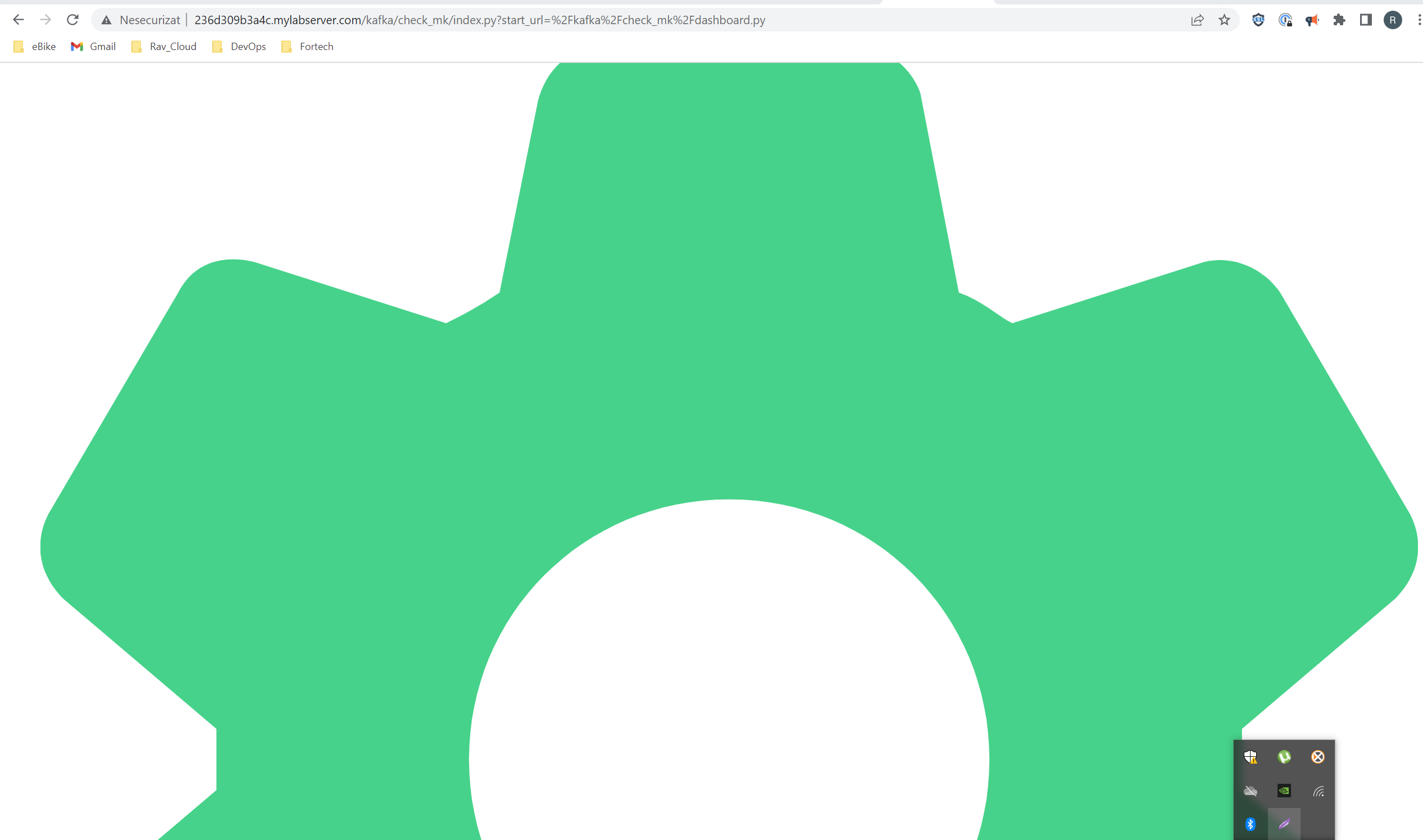

The icons loaded are very big:
On this VM there is no firewall.
On Centos is the same, with firwall and selinux disabeld.
I want to use checkmk for a POC and so far I am stuck.

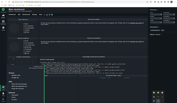

Same server setup but with different version of checkmk it works. (2.0.0p27)

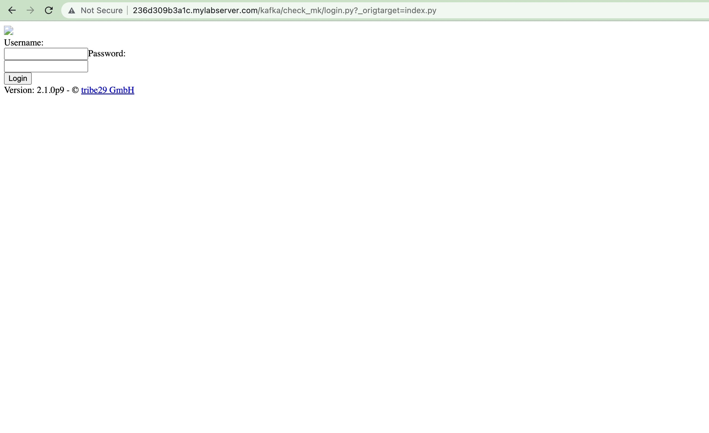

I am having the same issue.
Identical issue where none of the icons are displaying.
