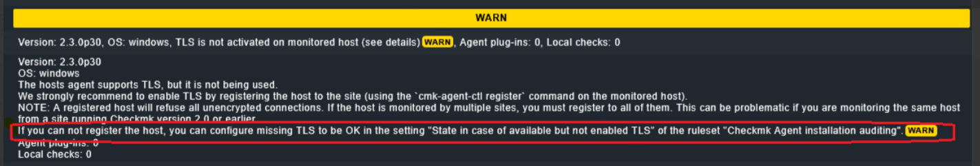

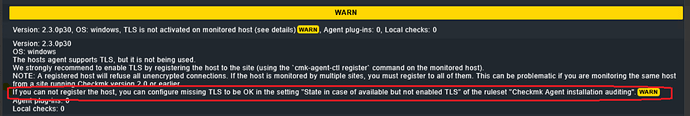

Summary
Version: 2.3.0p30, OS: linux, TLS is not activated on monitored host (see details)WARN, Agent plug-ins: 0, Local checks: 0
Details:
Version: 2.3.0p30
OS: linux
The hosts agent supports TLS, but it is not being used.
We strongly recommend to enable TLS by registering the host to the site (using the cmk-agent-ctl register command on the monitored host).
NOTE: A registered host will refuse all unencrypted connections. If the host is monitored by multiple sites, you must register to all of them. This can be problematic if you are monitoring the same host from a site running Checkmk version 2.0 or earlier.
If you can not register the host, you can configure missing TLS to be OK in the setting “State in case of available but not enabled TLS” of the ruleset “Checkmk Agent installation auditing”.WARN
Agent plug-ins: 0
Local checks: 0
