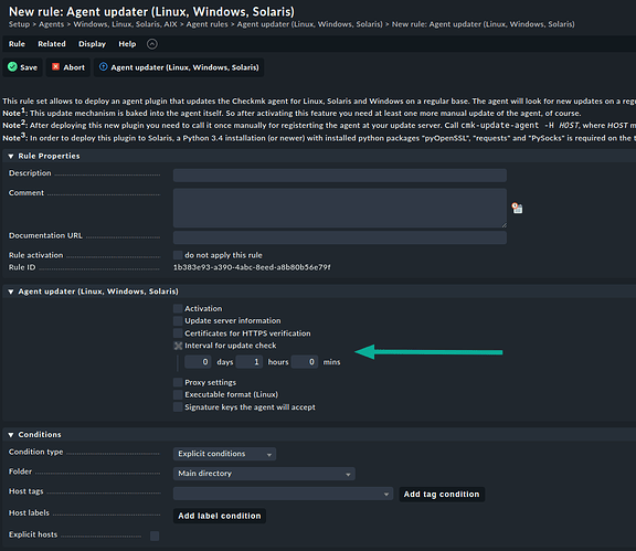

Did you check the “Agent updater” rule?
Unfortunately, I don’t know exactly what you mean. Can you please explain it to me in more detail?
Hi @freindl and welcome to the forum.
@Humaer wanted to know what update interval for the agent updater is configured.
You can find that by navigating to the Agent updater (Linux, Windows, Solaris) rule. Located at Setup → Agents → Windows, Linux, Solaris, AIX → Agent rules → Agent updater (Linux, Windows, Solaris)
Please check the update interval for the agent updates.
Hope this helps. :slightly_smiling_face:

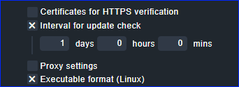

Please don’t get me wrong, but to me it looks like that you have some weird design in agent. Maybe I’m wrong but this is not only about messages in log, but also that agent update checking process itself is spawning every minute and it is ignoring the value entered in portal in “Interval for update check”.
checkmk_interval
Or, the update process will really happen based on the value in portal, but the messages are written to log not when the update process spawn, but independently (every minute because of older systemd) of update process?
